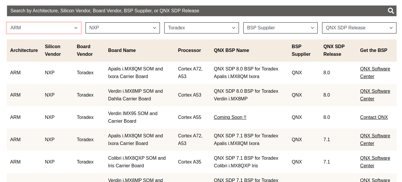

Hello! Thank you for your question regarding the Apalis iMX8 Evaluation Kit 2 and its suitability for your virtualization architecture.
The Apalis iMX8 family, including the Apalis iMX8QM, features hardware virtualization capabilities, making it technically suitable for use with a hypervisor such as the QNX Hypervisor. QNX BSPs (Board Support Packages) for QNX 8.0 and QNX 7.1 are available directly from QNX, and these support running QNX as a guest OS on this hardware. Key system interfaces such as I2C, SPI, CAN, Ethernet, USB, UART, and GPIO are supported as well. Graphical frameworks such as Qt for QNX user interfaces are also available through Toradex partners.
Android guest OS support, including Android Automotive OS (AAOS), is offered via partners like Sibrain Technologies and Kynetics, who provide commercial Android 14 and AAOS 14 support for Apalis iMX8 modules.
However, while the Apalis iMX8 hardware supports virtualization, there is no explicit public documentation confirming successful deployments of QNX Hypervisor running both Android (including AAOS) and QNX guests together on this platform. This means that while each component is supported individually (QNX RTOS, Android/AAOS, Qt for QNX), the specific combination you outlined (QNX Hypervisor with QNX and Android/AAOS guests) has not been officially documented or validated by default for this evaluation kit.
For more details on the available support and resources, you can refer to the QNX, Android, and hardware pages:
If you require a fully validated stack with QNX Hypervisor and dual guest OS (QNX + Android/AAOS), you may need to collaborate with QNX and Android BSP partners for integration and validation.
