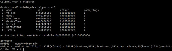

My nand partition is structured as shown bellow:
There is any solution for this or always my directory should have rw permission?
