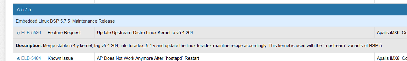

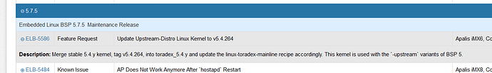

- I thought you upgraded the kernel version in 5.7.6, why is it still downloading 5.4.193 ?
