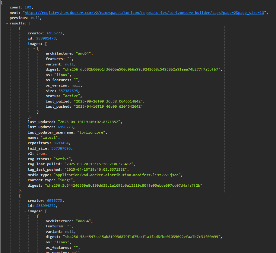

I’m attempting to install tcb for the first time on WSL2. The tcb-env-setup.sh script appears to be failing when trying to obtain the list of tcb tags from the docker hub registry. When I attempt to load the docker URL in a browser I get what seems like a valid response.
Output from tcb-env-setup.sh and the browser:

I think I have found the answer myself. Our corporate proxy often causes issues for curl with ssl certificates. I modified the tcb-env-setup.sh script to add the “-k” option to curl disabling certificate verification and it completed successfully.
The correct way to resolve this kind of issue is to provide curl with the corporate ssl certificate.
I followed the info discussed in this superuser.com article and was able to execute the tcb-env-setup.sh setup script without having to add the -k option to curl.
