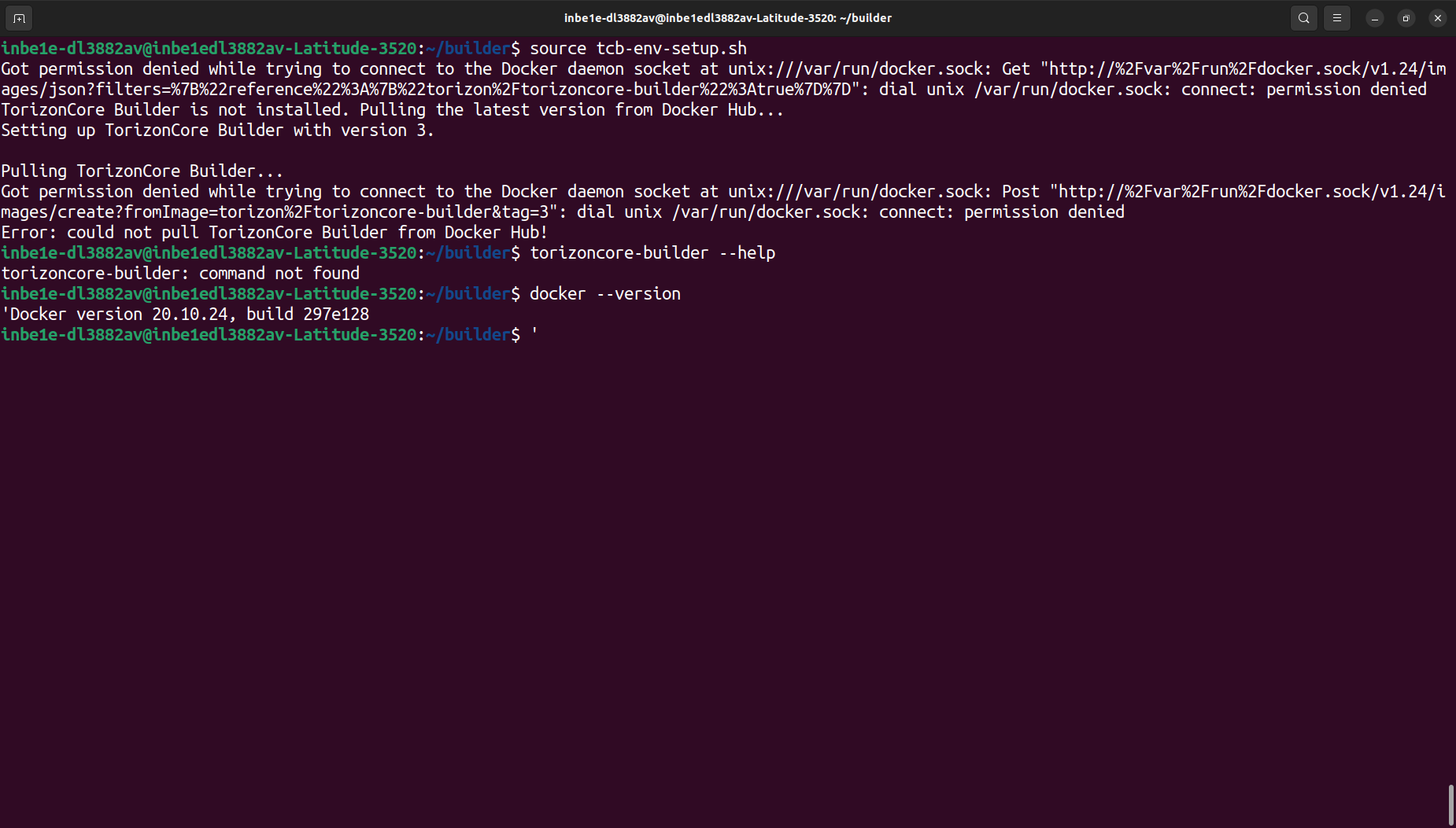

I am trying to install TorizonCore Builder tool on my device Ubuntu 22.04.3 LTS by following the TorizonCore Builder tool and I am able to download the setup script, but facing the error from source setup script as show in the image

Greetings @NAVIN,
It looks like you have not configured your device to be able to run docker commands as a non-root user. Could you try configuring your system as documented here: Post-installation steps | Docker Docs
Then retry the setup script.
