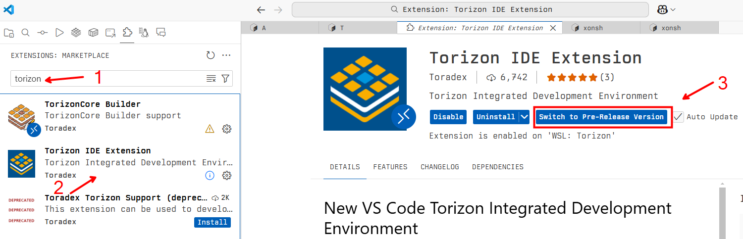

Hello @jonmills,
I know that Matheus is currently experimenting with some things so that the extension does not depend on Windows firewall anymore. He will update you soon. Thanks for your patience.
Thanks for the feedback @rudhi.tx .
I’m currently working in a Ubuntu VM (which is slow) (and considering re-building my laptop to run Linux natively), which is much easier than trying to work around the WSL firewall issues, but it would be nice to have the option of working in Windows.

We have some experiments under the dev branch that are ready for feedback. If you feel comfortable trying, it would be great. Before all, please follow the instructions here on this page Settings - Using Templates Development Branch | Toradex Developer Center to set your VS Code settings to point to the latest development branch of templates.
Also, you will need the pre-release version of the extension. To get the latest development pre-release version, go to the marketplace, Torizon extension, and then click on Switch to Pre-Release Version:
To make sure VS Code will load the new extension version, reload the window.
A new project needs to be created from scratch to test the new Docker host feature, use the old projects previously created on old versions will not work, ok?
