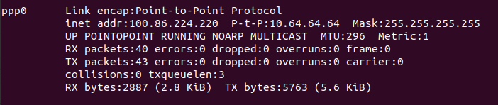

What I am trying to do is setting up the route table for transferring the data packets through the GSM network using pppd, where I need to set up the default route for the ppp0 interface, which I am trying to after the network is up.
These are the exercise which I have done
executing command
#route add default route 8.8.8.8 ppp0
This command is executed from the bash script which is placed inside the
/etc/ppp/ip-up.d
Please find the snaps for the log information:
The ppp0 network availibility

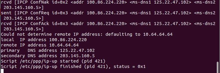

This is the pppd logs after the connection is established when no ethernet is connected.

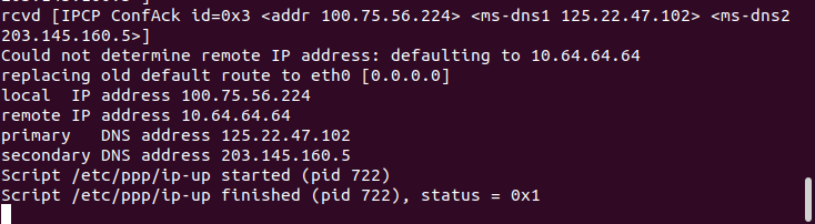

If an ethernet connection is made than the default route is replaced with 0.0.0.0 for the eth0

I am able to resolve the replacing the default route of the pppd connection and setting up the default route in ppp configuration file.
1. Add the defaultroute-metric 192.168.1.1 to /etc/ppp/peers/provider (Which is the pppd configuration)
2. Remove replacing the replacedefaultroute in the /etc/ppp/peers/vivo-3g.provider
