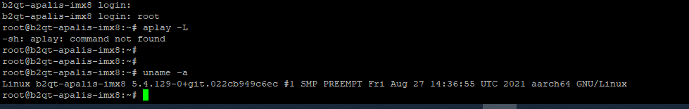

- Currently the “aplay” command is not working

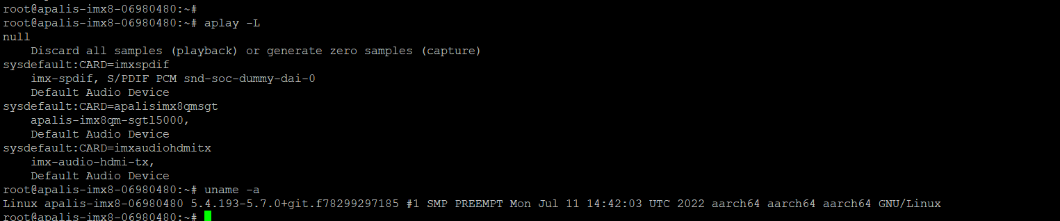

Can you please share with us the exact command you’re running and what is the output? Did you select the right audio channel? What’s the output of a aplay -L?

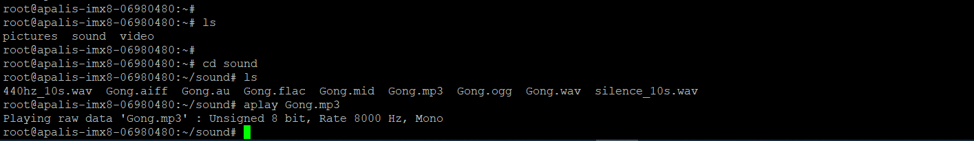

I am able to play the songs in reference multimedia image of toradex using aplay. Which driver files I need to load in boot2qt image inorder to play the .wav or mp3 sound files?

Thanks for the update. So what happens is that the Boot2Qt does not come with the alsa packages by default. What you’d need to do is to add at least the alsa-utils and alsa-utils-aplay packages to a custom Yocto Boot2Qt Build.
You can see here how we add them to the reference multimedia image: packagegroup-tdx-cli.bb « images « recipes-images - meta-toradex-demos.git - Toradex BSP layer, recipes for the demo images
You may want to follow this page for reference: How to create a Boot to Qt image | Boot to Qt documentation | Qt 6.9.2

To play some files, you might need to set the right sound output and the sampling rate, data type (8/16/32bits), etc of the music file.
Please check the Audio (Linux) | Toradex Developer Center article.
