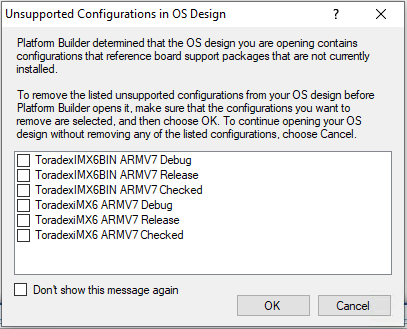

After many hours of installation of VS2008, SP1, some additional updates Toradex recommended, WinCE7 and each of it’s update packages I found at Microsoft, the platform builder in VS2008 appeared as part of it and tried to rebuild the OS kernel from Toradex. Therefore I opened the solution file in IMX6_Core7 and got following message:
I didn’t remove these unsupported configuration yet.

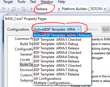

Assuming your kernel is not built for ARMV7 I first tried to build each of the ARMV5 and ARMV6 configurations first (i.MX6 is Cortex-A7 or -A9, but neither ARMV5, V6 or V7, as I know)
And each of them terminated after a short time missing anything in C:\WINCE700...\armv5... or in C\WINCE700...armv6...
The only configuration where build ran for a long time are BSP Template ARMV7 XXXX and Debug/Release (although loading the project complained the ARMV7 configurations).
Attached you find the build log file of my unsuccessful “Release” build. In the end “CreateDirectory” is the command that failed, but the directory is the base directory of the project, independent of how I called it. And there is no need to create it.

Nevertheless I am still confused about the first message in my yesterday mail that recommends to delete the only useful configurations. Any idea?
