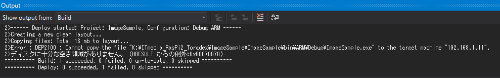

In the “Windows 10 IoT starter kit” of Toradex, can no longer placement of application of UWP. I was moving without a problem until yesterday, today has just placement errors, do not you work at all. The file is an error to the effect that can not be copied. Solution If you know, please help us.
“Error: DEP2100: file” C: \ Program Files (x86) \ Windows Kits \ 10 \ UnionMetadata \ Windows.winmd “can not be copied to the target computer” 192.168.1.11 "the.
There is not enough space on the disk. (Exception from HRESULT: 0x80070070) "
Error occurs.

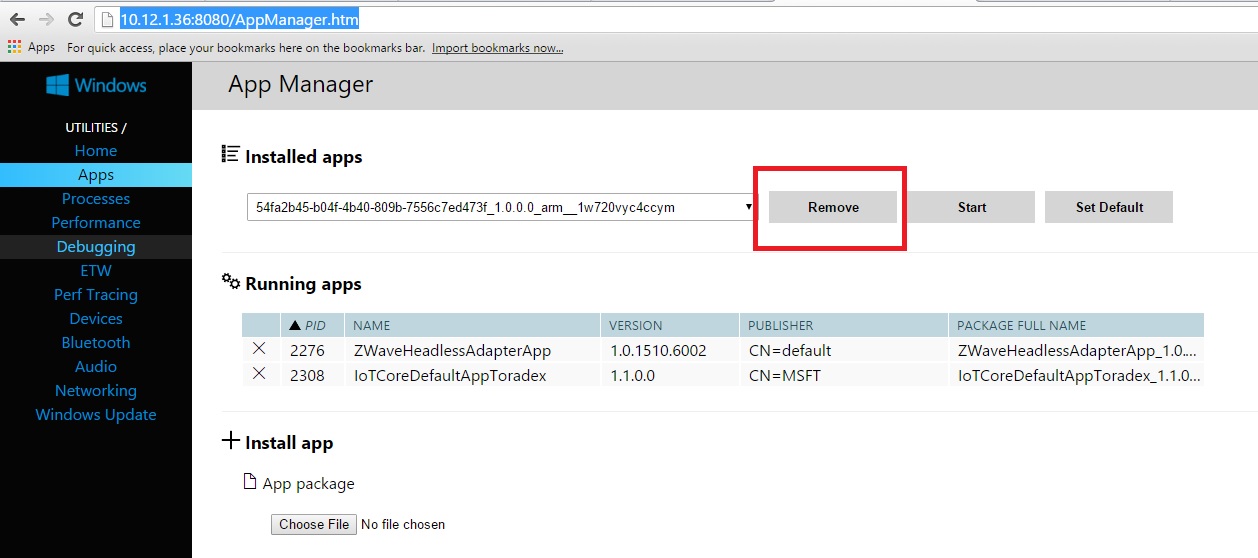

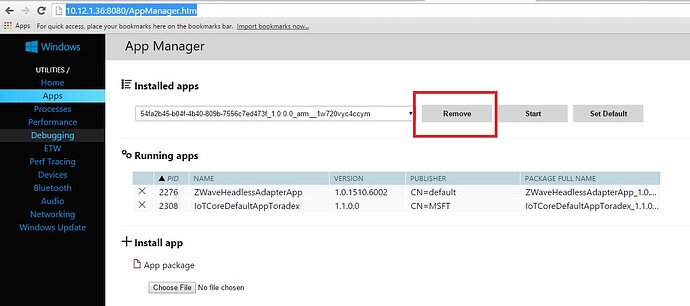

I also recommend to delete old application in the webinterface, maybe if you did a lot of test the 260MB are filled up.
http://IPADDRESS:8080/AppManager.htm

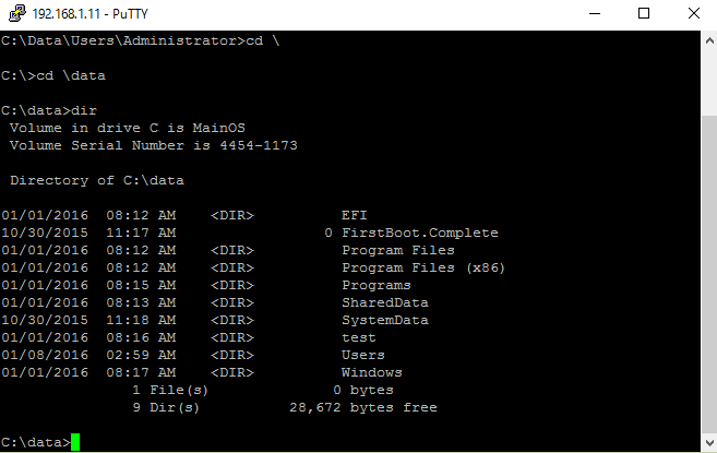

@Kuniyasu-san, can you try the following?
  1. go to the c:\data\ folder,
  2. check the size by “dir”.

The Remove Button in the webinterface does not remove all the files. For a complete removable you can delete the files the device in the folder
C:/data/Users/DefaultAccount/AppxLayouts/
You fill find a folder with the name of your application.
To access and delete the files you can use FTP, SMB, SSH,…

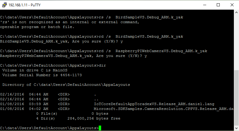

In App Manger, unnecessary files have been removed. However, there was from the original, only four of the files could not be deleted. Currently, there is only the four files.

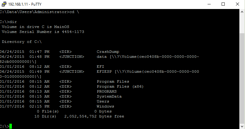

c:!126-名称未設定-1.png|658x414 does not exist folder called data \ folder2. So, you will see a message that says can not find the folder, such as shown in the figure.
Excuse me. It was a misunderstanding. c: free of \ data is as shown in the figure. It looks almost like there is no free.

Since the specified folder There was my created folders and files, we have removed every folder. Currently it has become a free space, such as shown in the figure. However, i
can not copy the lack capacity as usual 66MB of files. Small files can now be run can be copied. Although free space I think to be quite, Why 66BM about the file can not be copied?
Or free of memory is how much some of, but do not know well how to find, do you say in the accompanying image?
