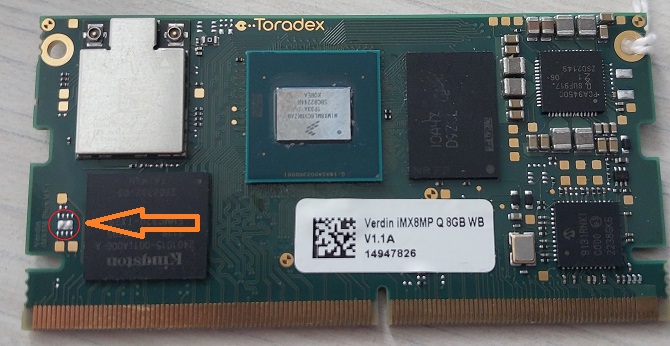

Could you please tell me how to check if my module has the temperature sensor mounted?
Could you please tell me the position of the temperature sensor on the module?

By default temperature sensor is not assembled. You have to place a special order to get Verdin iMX8M Plus modules with pre- assembled sensors.
VeriniMX8MP
Yes, the temperature sensor connected to the internal I2C line (I2C1 in SOC notation)
