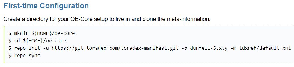

I’m currently following this guide: Build a Reference Image with Yocto Project/OpenEmbedded | Toradex Developer Center

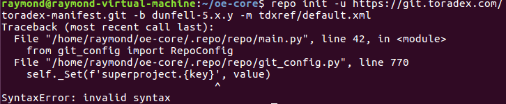

My Current steps in here:
My error output:
I followed everything and all my dependencies followed the YOCTO manual.

OK, so i found the problem and my solution.
When i go check my default python version using “python --version” it shows that its 2.7.x
I followed this to make 3.6 my default version and now it works.
