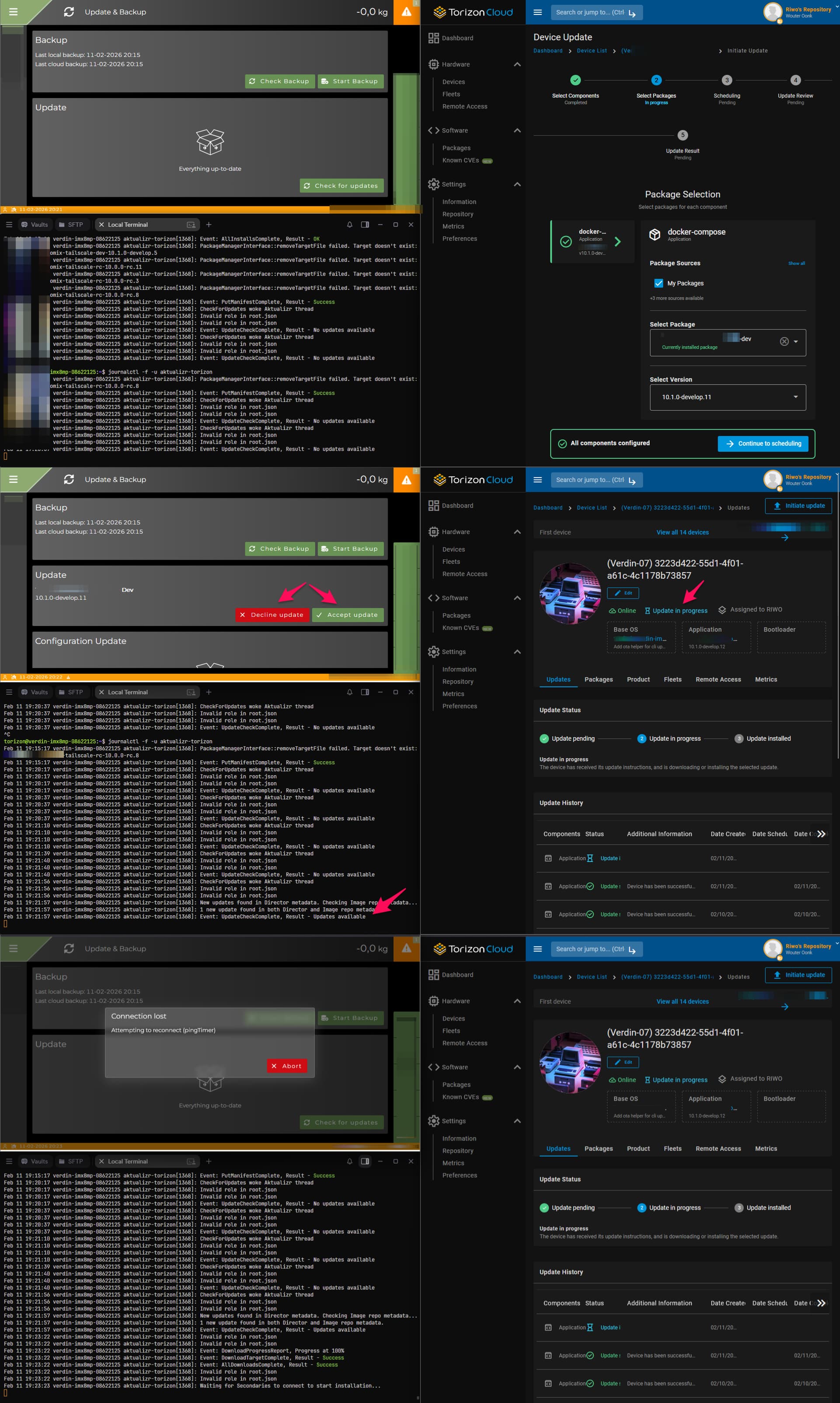

Hi everyone,
We are experiencing an issue with OTA updates in Torizon related to how user approval is handled.
When we schedule an OTA update, the device immediately switches to the status “Update in Progress”. From that moment onward:
  • we cannot cancel the update
  • we cannot replace it with a new update
  • and this happens even though the end user has not accepted or declined the update on the device
In our setup, the user is expected to manually accept or decline the update. However, many users do not interact at all. They do not accept and they do not decline. Despite this lack of user action, the device already transitions to “Update in Progress”.
Because of this, we lose the ability to retract or update the rollout for these devices, since the “in progress” state cannot be cancelled and prevents us from sending a new update.
Ideally, the device would remain in a state such as “Update Pending” until the user explicitly accepts the update. While the device is pending, we would still be able to:

Thanks for the explanation. We are already using the blocking mechanism in Torizon and our application shows the user a prompt where they can accept or decline the update.
The problem is that as soon as we schedule the update in the OTA dashboard, the device immediately switches to “Update in Progress”, even though:
  • the update is not downloaded
  • the user has not accepted or declined
  • the update is still blocked on the device via flock
Once it is marked “In Progress”, we cannot cancel it or push a new update anymore. This causes issues when users simply do nothing, because the update stays stuck and cannot be managed server‑side.
The real issue is the early transition to “In Progress” on the OTA backend. We expected the device to stay in Pending until the user explicitly accepts the update.
Our questions:
  1. Is this early switch to “In Progress” expected when using flock?
  2. Shouldn’t a device remain in “Pending” until the lock is released?
  3. Is there a way to prevent the OTA backend from setting updates to “In Progress” before user acceptance?

We have already implemented the Aktualizr D‑Bus API for user interaction. The user can accept or decline the update from our application, and we send the appropriate D‑Bus calls to Aktualizr.
However, our problem remains:
Even when we wait for user interaction on the device, the OTA backend already switches the device to “Update in Progress” as soon as the update is detected. At that moment:
  • the update has not been accepted
  • nothing is being installed or downloaded
  • we are only waiting for the user’s decision
  • but the server already marks it as “In Progress” and we can no longer cancel or replace the update
This is exactly the behavior we are trying to avoid.
What we would expect is that with the D‑Bus consent workflow, the device should stay in a Pending state until we send an explicit accept or cancel command via D‑Bus. Only after acceptance should it transition to “In Progress”.
Is this how the D‑Bus consent mechanism is intended to work?
Or is there currently no way to keep the device in “Pending” while waiting for user approval?

Thanks for the detailed explanation, Max.
We now understand the reasoning behind why the server switches a device to “In Progress” as soon as it detects the update. Also to be clear:
we fully understand that once an installation has actually started, it cannot be cancelled server‑side that makes complete sense.
However, our use case with the D‑Bus consent workflow runs into a different issue:
We would like the update to remain in “Pending” until the user explicitly accepts it on the device.
Right now, the OTA backend transitions to “In Progress” immediately when the device sees the update, even though:
  • nothing is being downloaded
  • the device is only waiting for the user to accept or decline via D‑Bus
Because of this early status change:
  • we cannot cancel the update anymore
  • we cannot replace it with a newer version
  • and if the user ignores the prompt, the device stays stuck in “In Progress”
While auto‑declining after X days is possible, it feels like a workaround rather than a proper consent‑based flow.
Is there any way currently or planned for a device using the D‑Bus consent mechanism to remain in “Pending” until it explicitly accepts the update?
This would align perfectly with a user‑consent workflow and avoid unwanted state transitions before the user has made a decision.
Thanks again for your support.
