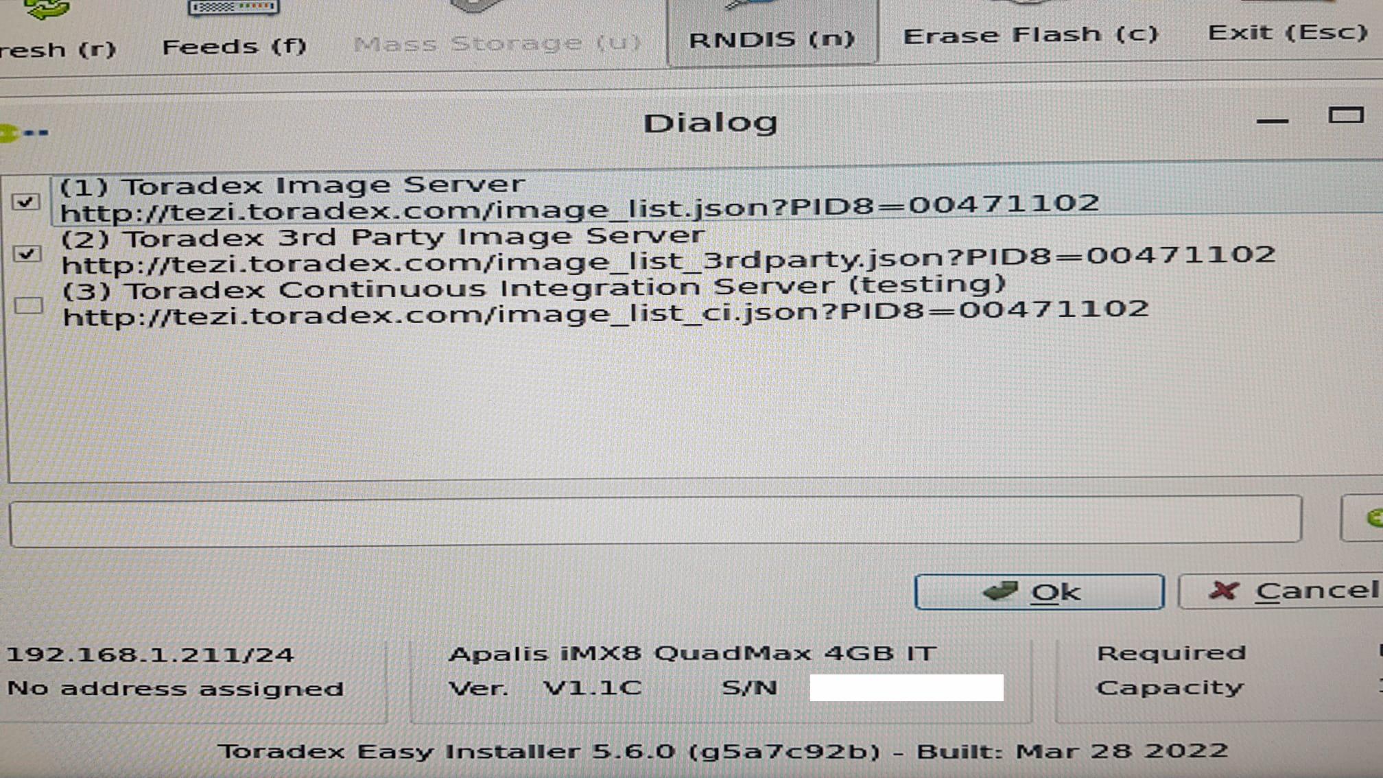

Could you send me a print screen of your Toradex Easy Installer main window and the “Feeds” window?
Hiago.

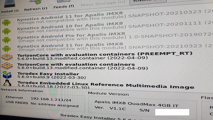

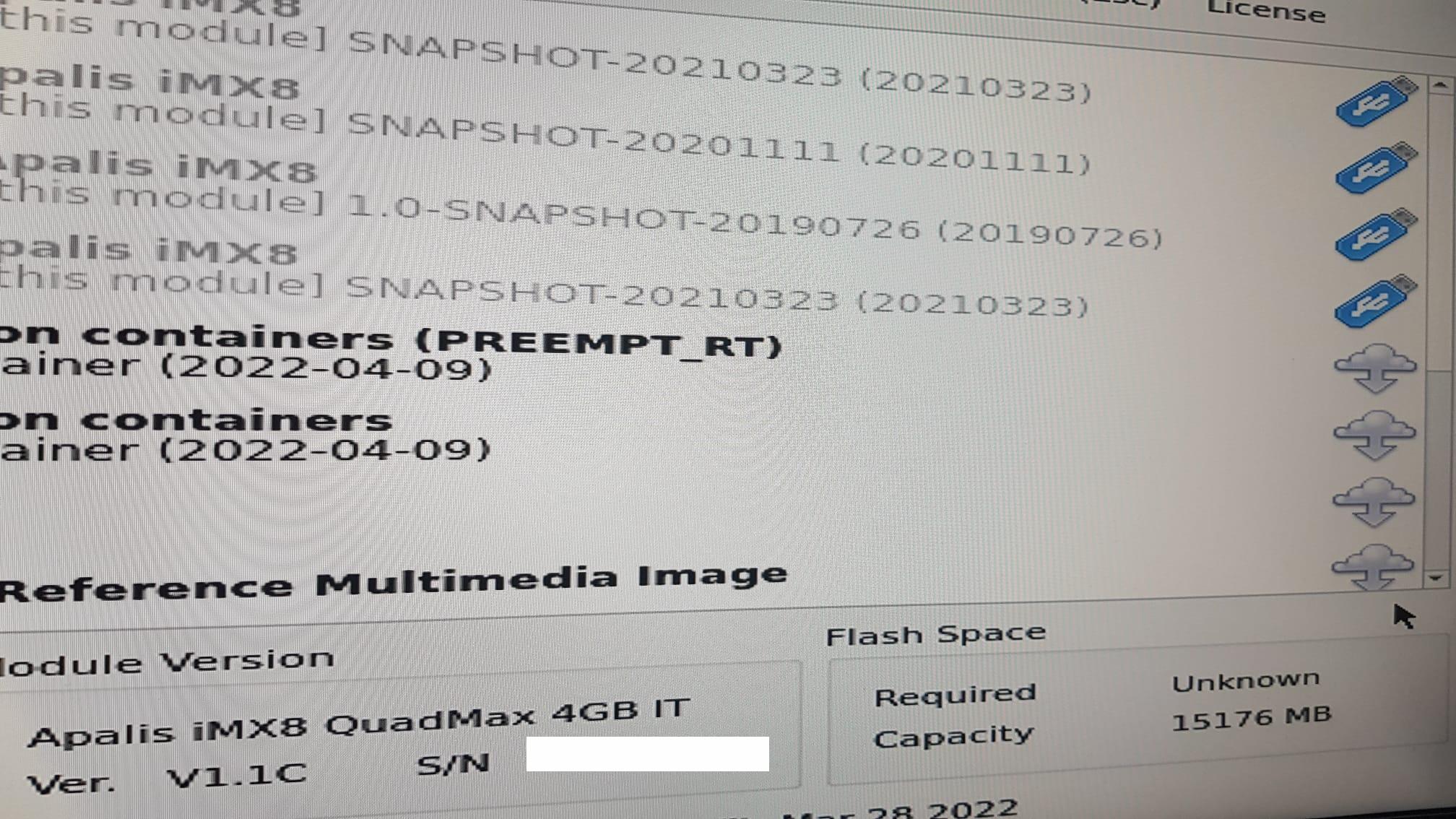

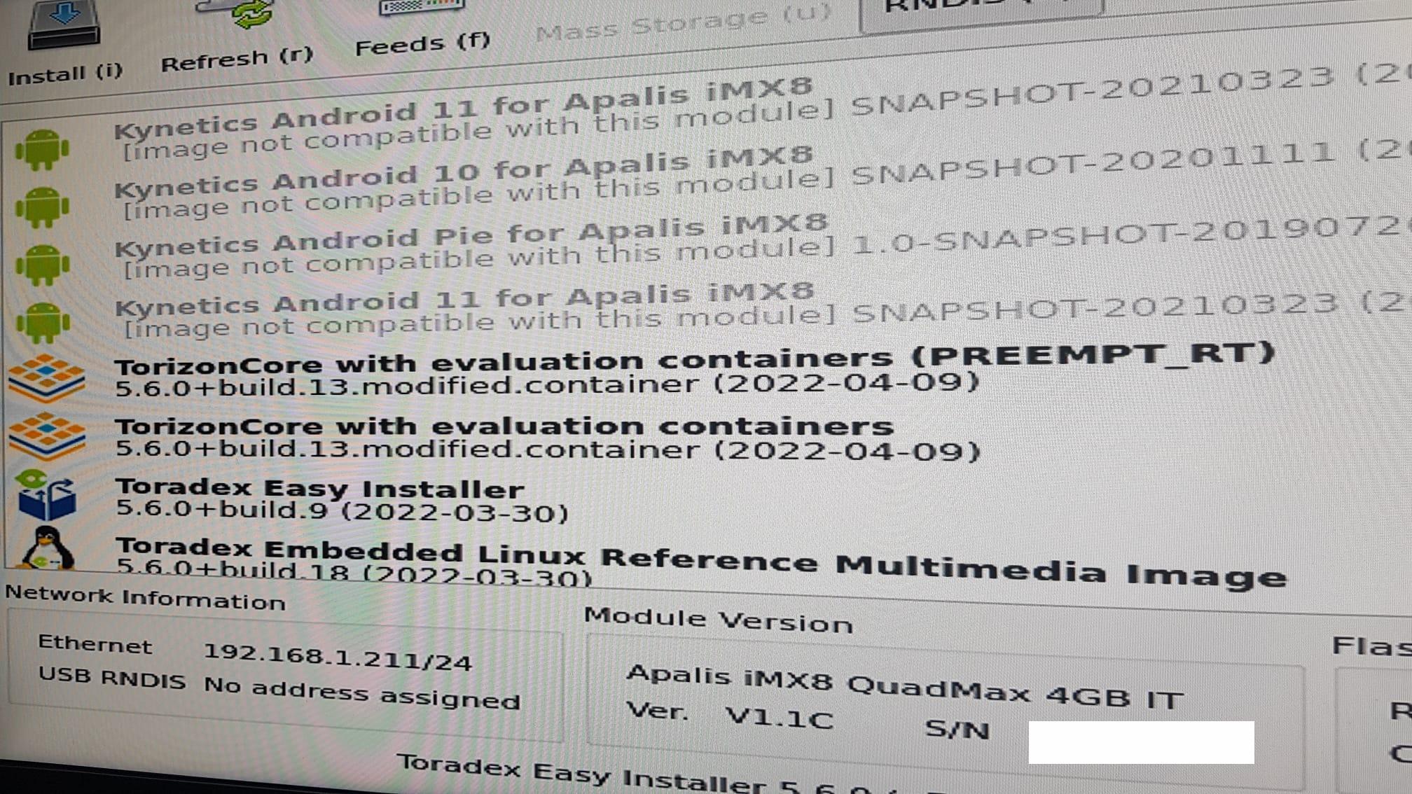

In the last 2 uploaded images you can see that the first 4 items in the list are the Android images read by TEZI from the USB memory. There are 2 duplicates of Android 11, because I copied it twice.
I also want to mention that if I edit the update links (see the first uploaded image) by removing PID8 = 00471102, I will get a bigger list of resources. This list also includes Android images (including the one which is dedicated to the IMX8 module), all of which are declared incompatible with my module by TEZI.

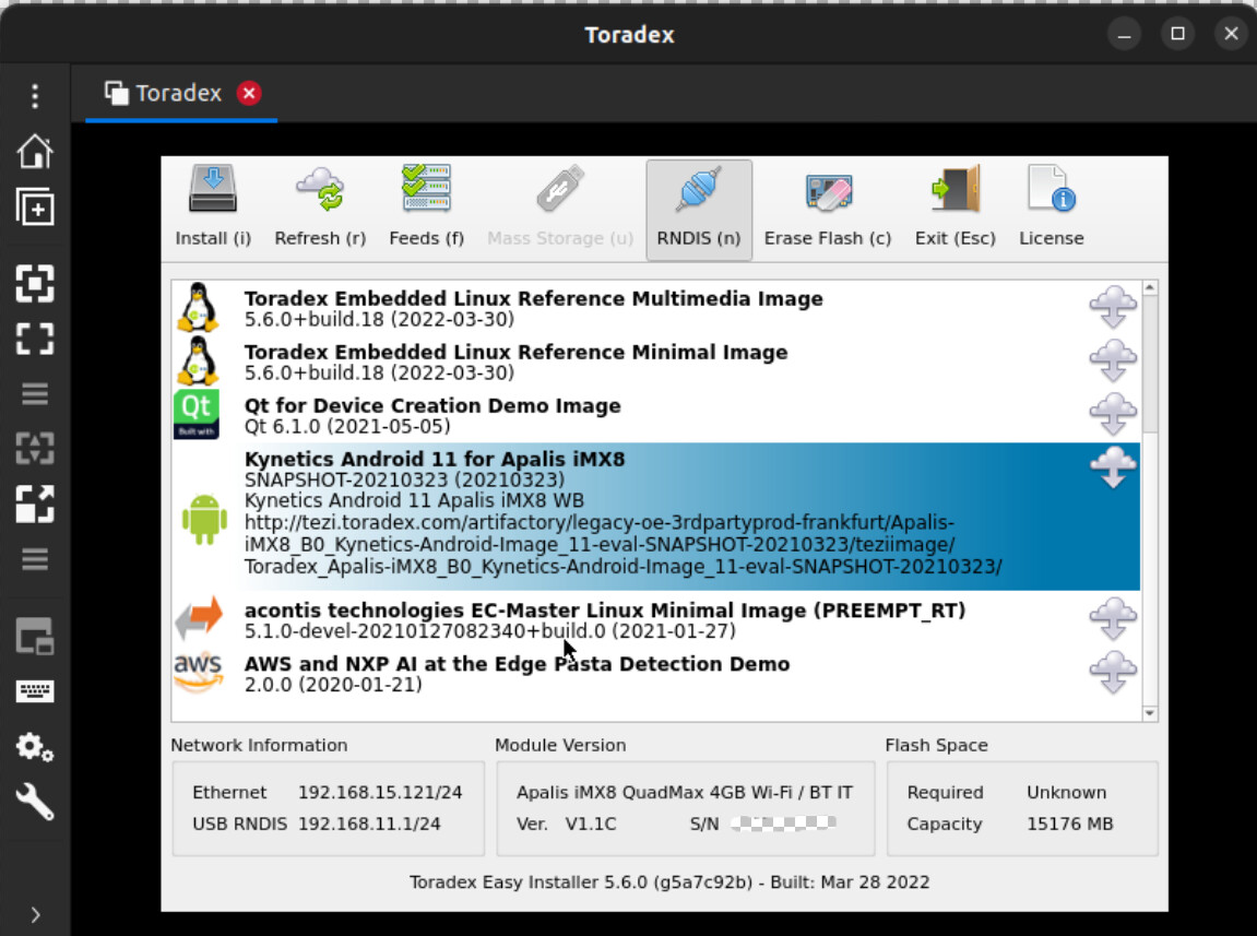

I’m not sure what happened, I’ll talk to our team here to discuss about this issue. Meanwhile, this is my screenshot:
As you can see, the image is available and I could install it.
You mentioned the PID8, here mine is https://tezi.toradex.com/image_list_3rdparty.json?PID8=00371102 not 00471102. Actually, this one gives me a 404 error. Can you try to add 00371102 manually and see if this works?

I changed the PID8 value in the update links with the one provided by you, and in the list of resources there are indeed images of Android, but these are also marked as incompatible with my module.
I also tried the option to exclude the string “?PID8 = 00371102” to access all the elements in the JSON file. Thus, TEZI shows all the resources available online for all the modules, but the problem is that all the Android images in the list are marked as incompatible with my module, including the one which is dedicated to the IMX8 platform.
In case of the 404 error that you received, you may not have edited the link correctly.

I noticed that you have an Apalis iMX8 QuadMax 4GB Wi-Fi / BT IT Ver. V1.1C. Mine is Apalis iMX8 QuadMax 4GB IT Ver. V1.1C. In your case, Wi-Fi / BT also appears which I think it means that your module is also provided with Wi-Fi and Bluetooth functions. I also noticed that the Android 11 image for the IMX8 module that you indicated in the image is reported as being for the IMX8 WB module. Since I do not have WB functions, it is possible that this image is incompatible with my module.

I apologize, I didn’t see that your module was different than mine, with W/B.
Makes sense now, as you can see in our revision history here, the part number of your module is 0047 and mine is 0037, that’s why we are seeing differences in our feeds, but it’s working as expected.
Checking our developer page about this image, we can see that your module without the W/B is not listed as supported. That’s why you’re seeing your module as not compatible, the image.json that is being loaded does not include your module.
However, I suspect that it should work, although Toradex doesn’t support it by default and we didn’t test it in your Apalis. Therefore, you’ll need to get the image with Kinects and test it to see whether it works or not. Meanwhile, I’ll talk with the marketing team to get more information.
