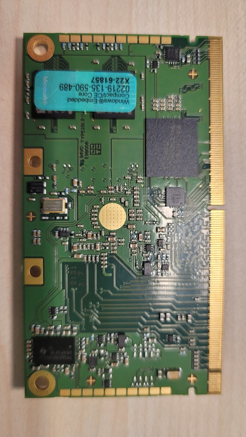

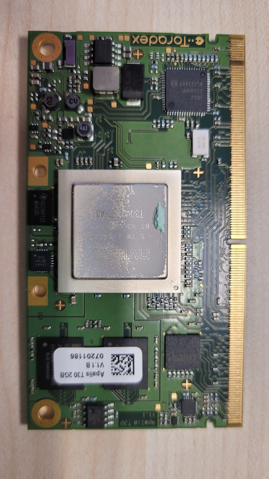

Hi @JanP ,
I see that the loader.nb0 downloaded successfully but then does not start. This points to a problem with either the CortexA9 CPU or the DDR. Both of those are not used during the first phase when loader.nb0 is downloaded BootRom will run from ARM7TDMI CPU and internal SRAM.
Is there any visible damage on CPU and RAM chips (chips off or burn marks)? Could be also a broken Crystal (12Mhz)
If the unit is still under warranty you can start a RMA process and we will get a a replacement. Can you send the serial number so i can check?
Hi @germano.tx
Even under a magnifying glass, I can’t see anything unusual. Attached is another photo of the front and back.
I’m not sure if the device is still under warranty. We produce the devices for stock, and they might sit there for a while. Perhaps you could check using the serial number.

Hi @JanP ,
From the pictures you sent i cannot see any damage, but it’s also hard to say from these pictures alone… would need more high resolution pictures and from divverent angles to check for bent or lifted components. Also some kind of damage might not be even visible (for example soldering contacts tear off unter the BGA components)
