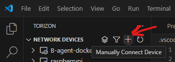

Trying to set the target ip address directly I get the error “ECONNREFUSED”
Okay, so now this is in addition to the whole detection issue correct? Basically even ignoring the detection problem if you force the VSCode extension to connect to the device via IP address that fails as well.
Are there any other logs or is this the only message? As a sanity test from within your WSL Linux distro can you manually SSH to the target device via the IP address?
