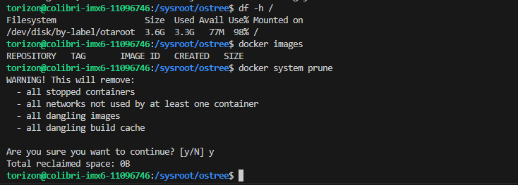

Then checking a couple of things…
And then trying to prune any old docker images…
It didn’t seem to help much

I’ve just been using the same docker container image as previously so the size shouldn’t be a factor.
I’m guessing that some old docker files are still hanging around after using the docker prune command and came across this link… which really helped
danger, read the entire text around this code before running you will lose data
$ sudo -s
$ systemctl stop docker
$ rm -rf /var/lib/docker
$ systemctl start docker
$ exit
