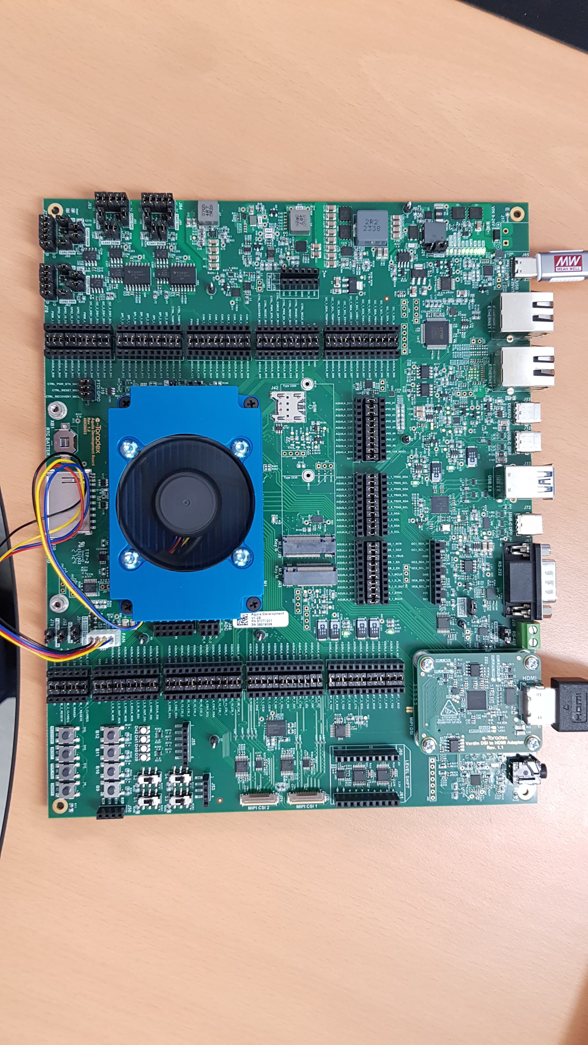

No display output on the Aquila AM69
Aquila AM69, Aquila Development Board, Yocto : kirkstone-6.x.y
There was no output at the first boot. after than, I build with tdx-reference-multimedia-image and boot from SD card. but not work. I tried connecting HDMI and DP. What I will check?

tested command : gst-launch-1.0 videotestsrc ! autovideosink
Hello! Thank you for providing a detailed boot log and sharing your setup with the Aquila AM69 and Development Board.
Based on your logs and description, here’s how to troubleshoot and verify display output for both HDMI and DisplayPort:

Hi @LeeBak365
Can you test if you get the same results in our latest BSP 7?
You don’t need to build it yourself, you can test it with a pre-built image.
The reference multimedia is expected to show the Qt cinematic experience demo.
The display work good.
DT to DT : success
DT to HDMI : x
HDMI to HDMI : x
My test results that only DT to DT cable works.
I failed to build BSP 7.
I don’t know how to boot with pre-build BSP. Please give me a link.
Also tell me how to create sdcard and boot from it.
I also want to know about device tree.
thanks
@LeeBak365
You mean DP right?
  • DP to DP
    • Yes, everything should work as expected using a DP cable connected to a DP monitor
  • DP to HDMI
  • HDMI to HDMI
    • You need to enable the correct overlay, which is currently only available in the nightly builds, it’s planned in the next release.
Do you need to use HDMI specifically?
