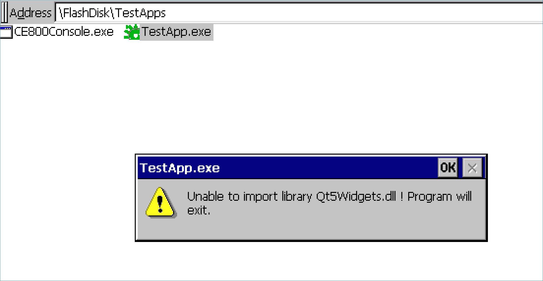

The build completed. I copied everything to \FlashDisk\System. However, I now have the problem where trying to load any Qt app that uses any of the Qt DLLs throws up the error:
Note that this is not the path error that displays if the DLL is “not found”. It won’t “import” it.
This seems to be related to the -MT vs. -MD option during compilation in Visual Studio. I used -MT and did not have that issue, but -MD won’t work. Any hints as to why?
Thx

Ok, I rebuilt using -MT and that made no difference. I still get the import error trying to load any Qt app. I don’t know if it is a Qt paths thing or not – very frustrating. Everything compiles without error but nothing will run.
Maybe I will try compiling static Qt libs just to see if it works since I’ve been through the Qt source compile about a half dozen times now…
