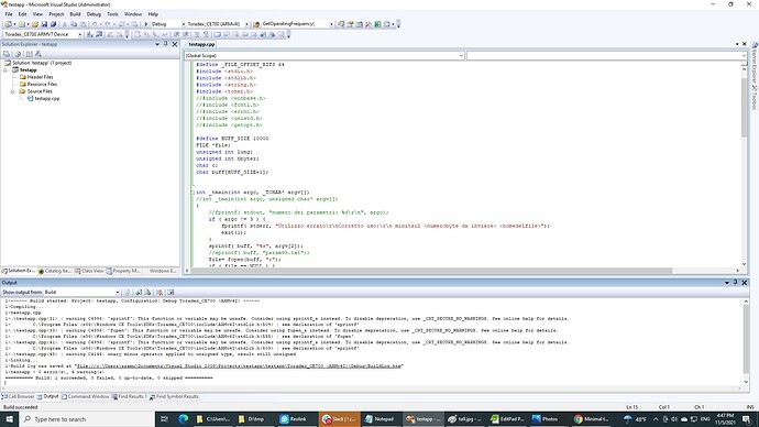

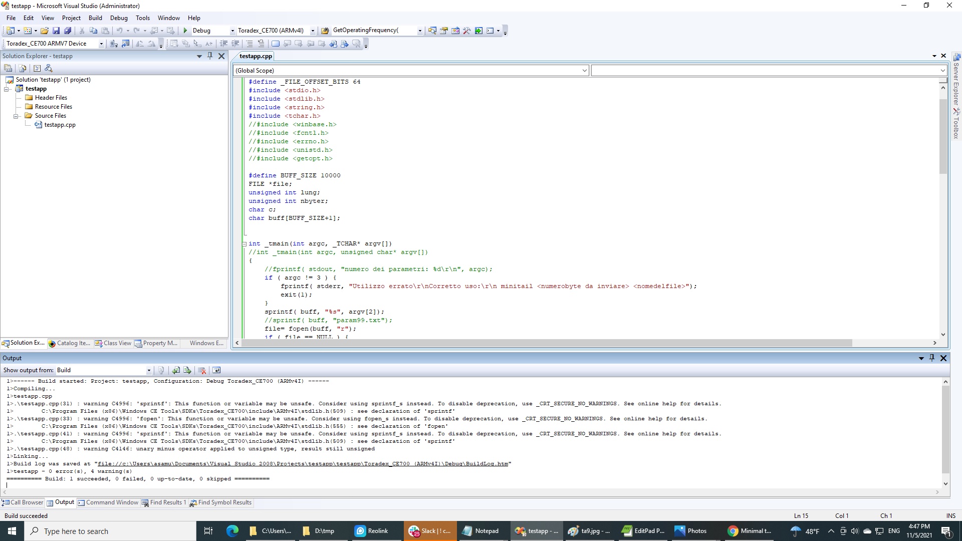

BUT now the compiler says that is unabled to compile for colibri ARM
I tried to compile it and everything went well.
