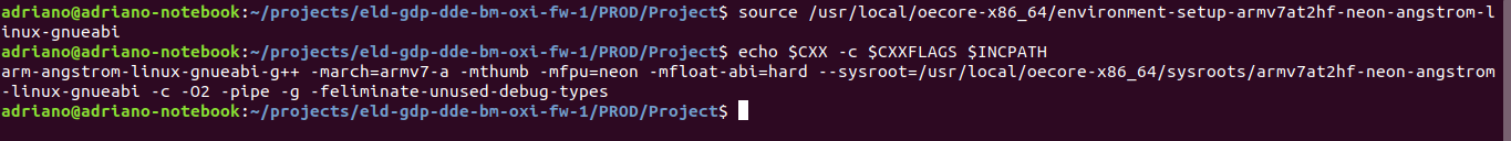

Line 1406 command: $(CXX) -c $(CXXFLAGS) $(INCPATH) -o main.o …/ihm-vertex/main.cpp
I also echo the command line variables:
Makefile code snippet:

Hi @adrianomunin.eld ,
That’s strange, the environment variables seem to be correctly configured on your terminal, but the Makefile seems to be getting other values. Can you please provide the exact steps you are executing?
