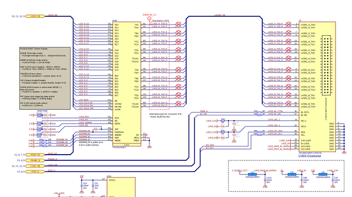

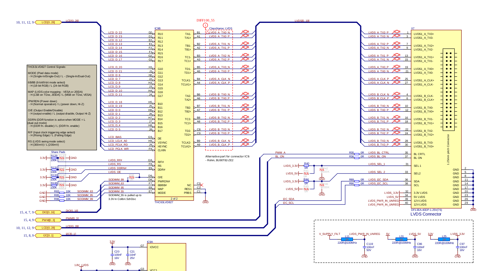

Can you give us more information on the single-channel display you are using?
The Iris V2.0 RGB to LVDS converter allows being configured to dual-channel and single-channel output.
You have to build a customized cable. In the schematic of the IrisV2.0, you find a table with the converter configurations. With the Mode pin, you can switch between single-channel and dual-channel output.
please take a look at our schematic of the IRIS V2.0. Iris Carrier Board | Toradex Developer Center
