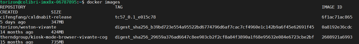

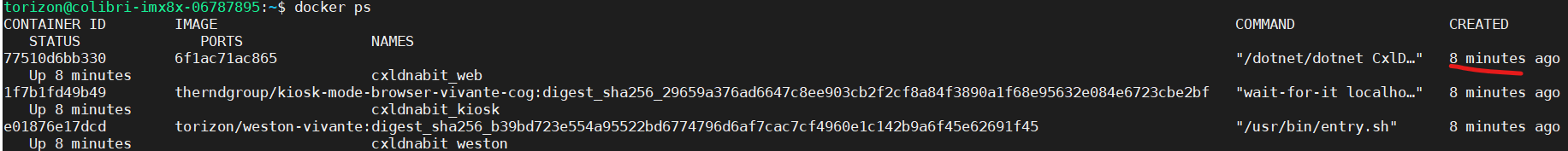

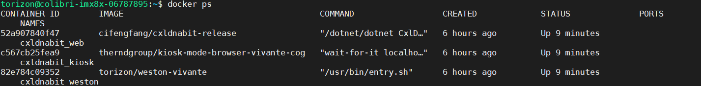

Hi, I was trying to test out the secure offline update features with a lockbox to achieve containers update. The lockbox was recognized just fine from the aktualizr log, but it doesn’t do the custom app container update correctly.
For the weston and cog containers, I can see it removes the old images and containers and update docker-compose.yml to start the new containers, but for our custom app container, the update tool somehow just removed the new images and keep the old one, while it modifies the docker-compose to start the new one (which is removed by the tool actually). As a result, the update doesn’t reboot at the end, and once I force reboot the device the container failed to start.

Dec 08 03:05:27 colibri-imx8x-06787895 aktualizr-torizon[1746]: Deleted Images:
Dec 08 03:05:27 colibri-imx8x-06787895 aktualizr-torizon[1746]: untagged: cifengfang/cxldnabit-release:digest_sha256_68377c13050f5fe2b20959534e5dc6639431e070bdbac875bfef1310705727f2
Dec 08 03:05:27 colibri-imx8x-06787895 aktualizr-torizon[1746]: untagged: torizon/weston-vivante:2.5.1
Dec 08 03:05:27 colibri-imx8x-06787895 aktualizr-torizon[1746]: Total reclaimed space: 0B
