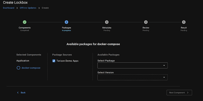

Lockbox creation does not show my docker compose packages
I uploaded some custom docker-compose packages to Torizon cloud. These I can normally use to do online updates on my devices. However when it comes to offline updates via lockbox i do not seem to find these packeges.
The UI when creating lockboxes only shows Torizon provided packages, but not my own:
Is there anything special I have to do in addition to be able to use my own app packages for offline updates?
