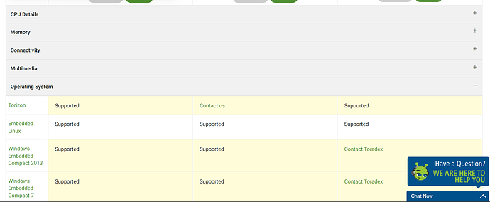

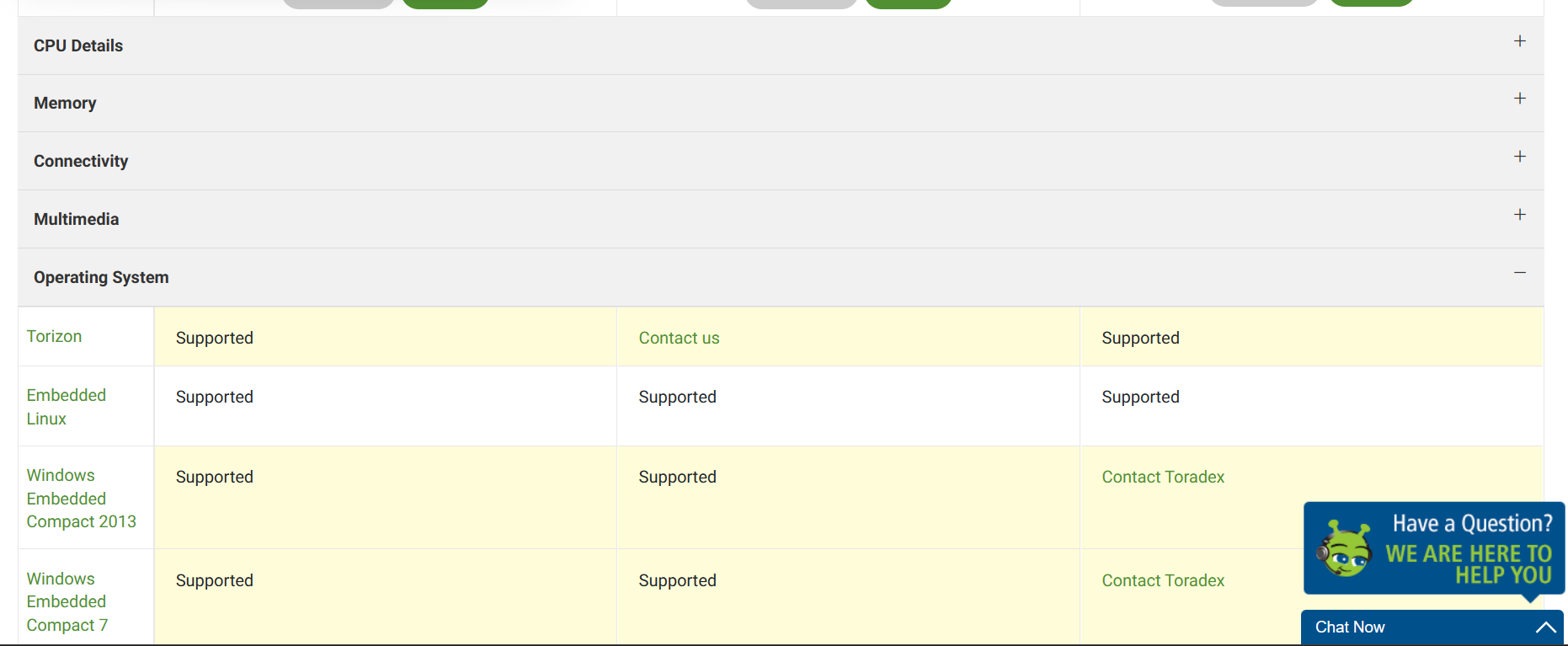

And i have a question that windows embedded compact runs on all IMX7 modules?
Toradex website shows that IMX7D 1GB emmc Support windows embedded compact 7 but no technical information as it mentions Contact toradex.
Hi @Nabeelahmed0505,
WinCE image is available for Colibri iMX7S 256MB and Colibri iMX7D 512MB and not for Colibri iMX7D 1GB.
For 1 GB variant, if you need WinCE image then this will be on support hour (chargeable) basis.

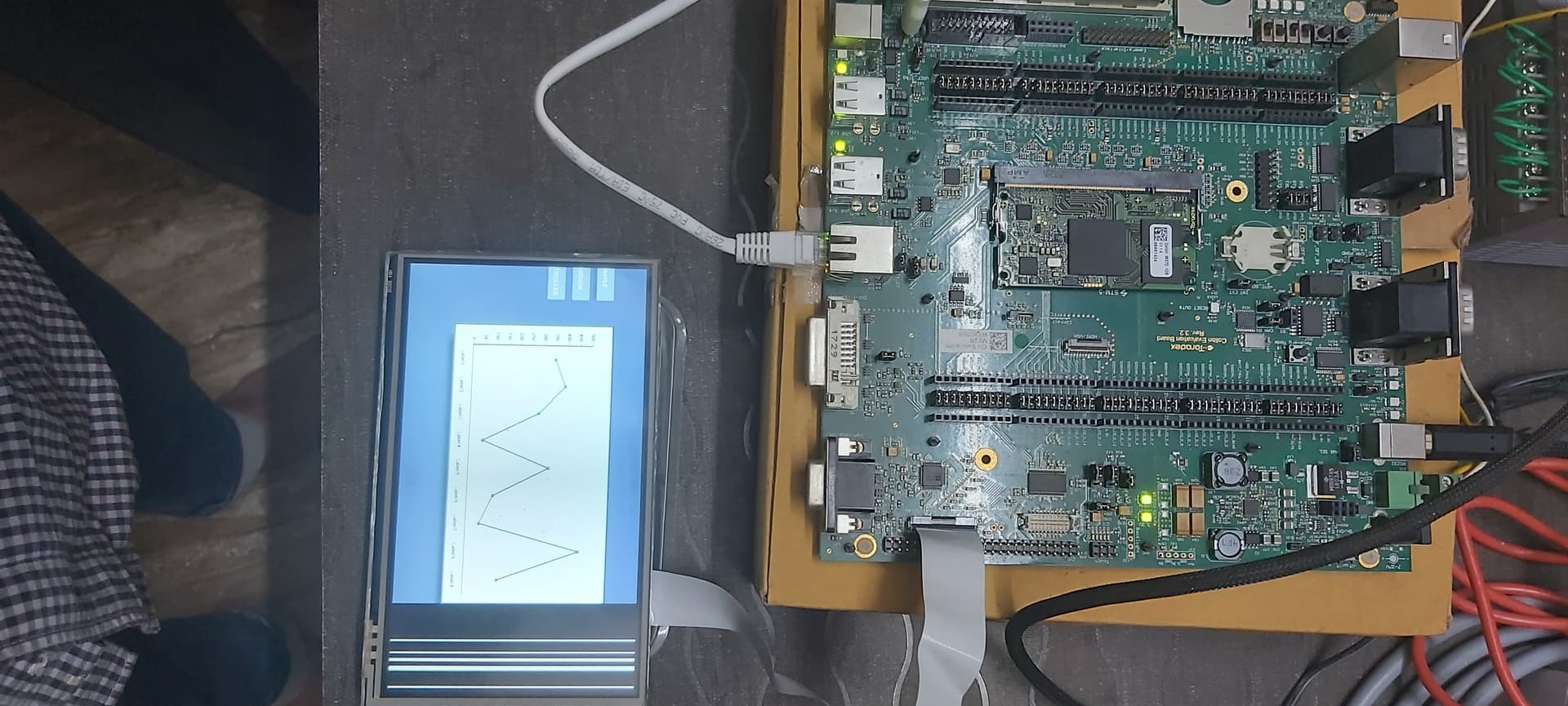

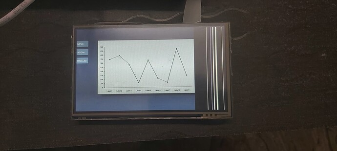

Instead of windows we want to evaluate Torizon which seems good starting point. We Evaluated Torizon with Crank Software and we runned a application.
But we are getting problem in evaluating application because of the display Resolution.
Crank Application resolution is already 800x480.
And we used this below link for display resolution but this is too complicated:
So please provide support on the display resolution setting and Touch Calibration on Torizon
we are using Colibri Evaluation Board V3.2 with IMX7D 1GB emmc V 1.1A.

For Torizon display settings , please use this article.
yes i have done it.
