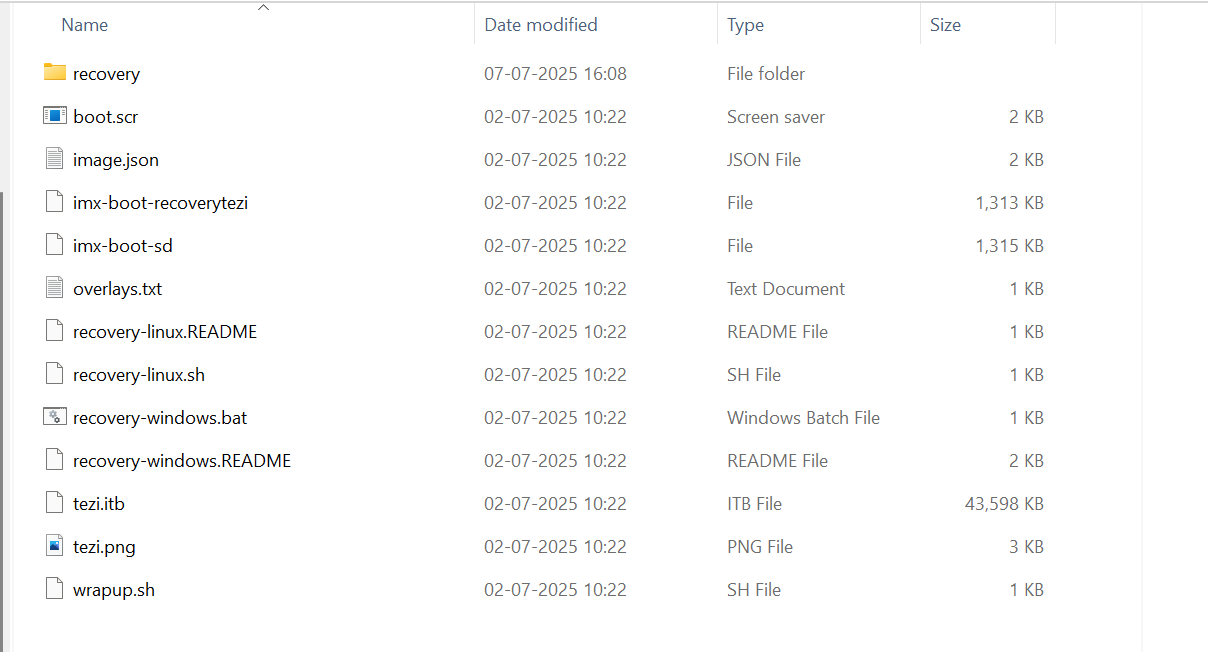

Thanks for the response,
I have extracted the TEZI in the SD Card as shown in attached picture, then i have inserted the sdcard into the carrier board and then i have powered on but the tezi is not loading, the old OS 's splash screen is loading, is there anything need to be done while booting.
Hi @sankarn!
Are these files in the root of the SD Card? These files must be in the root, otherwise it won’t start the TEZI. I’ve tested it again, and it worked as said before.
Best regards.
did you check if your sd card is bootable?
