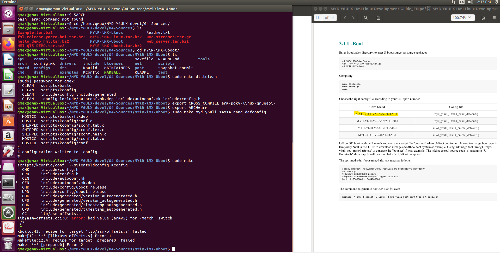

(4) Now trying to make u-boot config and compiling it with that able to generate config file but facing issue while compiling it,
(a) Sourced the metaToolChain
(b) Entered the U-bootsource file directory
(c) given sudo make distclean
(d) Exported the env variables CROSS_COMPILER and ARCH
(e) sudo make the core board of one i’m using is MYC-Y6ULY2-356N256D-50-C
(f) sudo make But cant able to compile. Can any one please help on this to solve the issue?
qmax@qmax-VirtualBox:~/MYD-Y6ULX-devel/04-Sources/MYiR-iMX-Uboot$ sudo make distclean
[sudo] password for qmax:
CLEAN scripts/basic
CLEAN scripts/kconfig
CLEAN include/config include/generated
CLEAN .config include/autoconf.mk.dep include/autoconf.mk include/config.h
qmax@qmax-VirtualBox:~/MYD-Y6ULX-devel/04-Sources/MYiR-iMX-Uboot$ export CROSS_COMPILE=arm-poky-linux-gnueabi-
qmax@qmax-VirtualBox:~/MYD-Y6ULX-devel/04-Sources/MYiR-iMX-Uboot$ export ARCH=arm
qmax@qmax-VirtualBox:~/MYD-Y6ULX-devel/04-Sources/MYiR-iMX-Uboot$ sudo make myd_y6ull_14x14_nand_defconfig
HOSTCC scripts/basic/fixdep
HOSTCC scripts/kconfig/conf.o
SHIPPED scripts/kconfig/zconf.tab.c
SHIPPED scripts/kconfig/zconf.lex.c
SHIPPED scripts/kconfig/zconf.hash.c
HOSTCC scripts/kconfig/zconf.tab.o
HOSTLD scripts/kconfig/conf
# configuration written to .config
scripts/kconfig/conf --silentoldconfig Kconfig
CHK include/config.h
UPD include/config.h
GEN include/autoconf.mk
GEN include/autoconf.mk.dep
CHK include/config/uboot.release
UPD include/config/uboot.release
CHK include/generated/version_autogenerated.h
UPD include/generated/version_autogenerated.h
CHK include/generated/timestamp_autogenerated.h
UPD include/generated/timestamp_autogenerated.h
CC lib/asm-offsets.s
lib/asm-offsets.c:1:0: error: bad value (armv5) for -march= switch
Kbuild:43: recipe for target 'lib/asm-offsets.s' failed
make[1]: *** [lib/asm-offsets.s] Error 1
Makefile:1254: recipe for target 'prepare0' failed
make: *** [prepare0] Error 2
