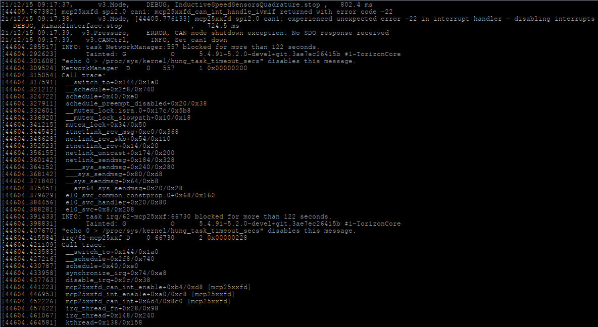

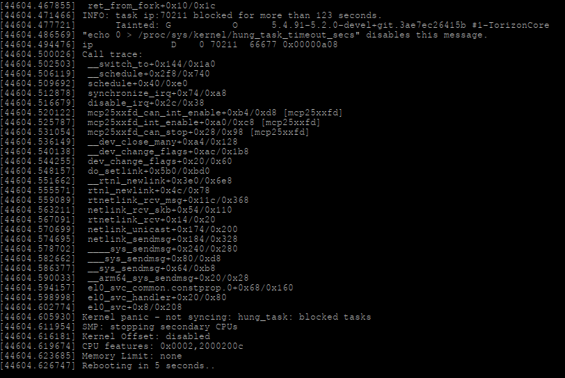

With the above test setup we were able to reproduce the issue and capture the kernel logs where the kernel hangs and the system watchdog triggers a restart. The kernel logs snapshot is attached below.
As you can see the MCP2517 driver throws an error which locks up the whole of network manager causing the system hang and restart.
