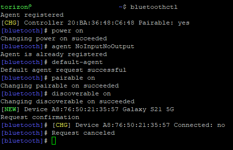

We are trying to get Just-Works pairing to work with the Bluetooth module (ideally via the launch of a script eventually). While almost everything seems to be working with BlueZ, we can manually connect by confirming the codes just fine, it will not initiate an automatic handshake regardless of the agents settings. I’ve tried using the following steps before attempting to connect.
power on
agent NoInputNoOutput
default-agent
pairable on
discoverable on
When attempting to connect our mobile device to the board, we are still prompted yes/no to confirm the connection. Which does work if I confirm yes on the board, but which of course defeats the purpose of Just-Works.

Hey @ngarman,
How are you coming along with this topic?
Could you try “agent off
” prior to to creating, this will remove the default user.
I was able to connect via my computer and mobile phone this way without prompt.
-Eric
