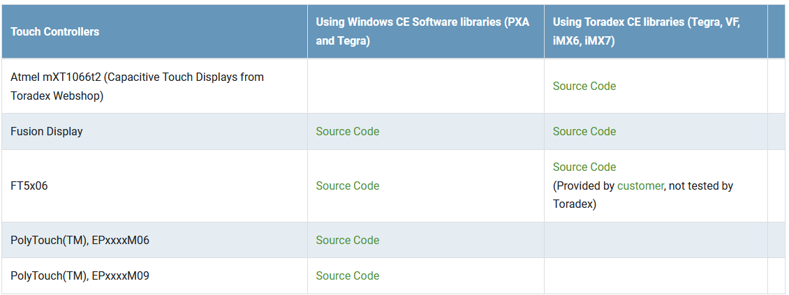

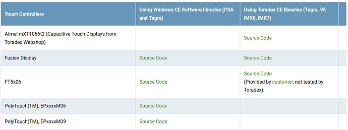

and the following website:
From what I understand, I have to use HwAdapt executable; the code is available on the developer toradex website
