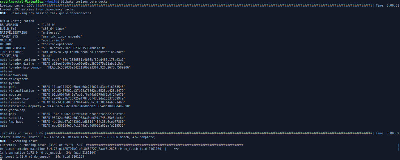

But now when I run the following command I have 4 errors now:
C:\Users\rfonc>docker run --rm -it --name=crops -v \\wsl$\Ubuntu-18.04\home\rfonck\yocto-workdir:/workdir --workdir=/workdir -e MACHINE=apalis-imx6 -e DISTRO=torizon -e IMAGE=torizon-core-docker torizon/crops:dunfell-5.x.y startup-tdx.sh
... A new version of repo (2.15) is available.
... New version is available at: /workdir/torizon/.repo/repo/repo
... The launcher is run from: /bin/repo
!!! The launcher is not writable.  Please talk to your sysadmin or distro
!!! to get an update installed.
nothing to commit (working directory clean)
Build environment configured. Building target image torizon-core-docker
> DISTRO=torizon MACHINE=apalis-imx6 bitbake torizon-core-docker
Loading cache: 100% |####################################################################################| Time: 0:00:01
Loaded 3892 entries from dependency cache.
NOTE: Resolving any missing task queue dependencies
Build Configuration:
BB_VERSION           = "1.46.0"
BUILD_SYS            = "x86_64-linux"
NATIVELSBSTRING      = "universal"
TARGET_SYS           = "arm-tdx-linux-gnueabi"
MACHINE              = "apalis-imx6"
DISTRO               = "torizon"
DISTRO_VERSION       = "5.3.0-devel-20210622182435+build.0"
TUNE_FEATURES        = "arm armv7a vfp thumb neon callconvention-hard"
TARGET_FPU           = "hard"
meta-toradex-torizon = "HEAD:ebe4f460ef1850551a4b66bf82dd480c178a93a1"
meta-toradex-distro  = "HEAD:a12eef0d00f2dce08e65ac3b70075a21abc5c5dc"
meta-toradex-bsp-common = "HEAD:2c539036e3421150b29336fc926b2678df589206"
meta-oe
meta-networking
meta-filesystems
meta-python
meta-perl            = "HEAD:11eae114522a6befa06c7f4021a83bc016133543"
meta-virtualization  = "HEAD:92cd3467502bd27b98a76862ca6525ce425a8479"
meta-updater         = "HEAD:b1bb00f4b645e7ab5cf6af4a6579df8b0f24e079"
meta-toradex-nxp     = "HEAD:ce70bcafb720725ef78fb3f47c2da153372099fa"
meta-freescale       = "HEAD:0173d3f8d0cbf7844a4d23bc3fb30144abc914bb"
meta-freescale-3rdparty = "HEAD:a7b96dc91bb2818d8ed8210654db10d08d4d7890"
meta-yocto-bsp
meta-poky            = "HEAD:134c1e9902148f907d4f9e78435fa3a827c6df03"
meta-security        = "HEAD:93232ae6d52b0d1968aa0ce69fa745e85e3bbc6b"
meta-lmp-base        = "HEAD:4bc19dd07a748301bbd8314f454c35a6ceb77880"
meta                 = "HEAD:ecd636154e7cfc1349a7cfd8026a85eafa219535"
Initialising tasks: 100% |###############################################################################| Time: 0:00:05
Sstate summary: Wanted 1040 Found 166 Missed 874 Current 1082 (15% match, 58% complete)
NOTE: Executing Tasks
ERROR: linux-toradex-5.4.115+gitAUTOINC+e4c8d52727_64dbf17bb3-r0 do_compile: oe_runmake failed
ERROR: linux-toradex-5.4.115+gitAUTOINC+e4c8d52727_64dbf17bb3-r0 do_compile: Execution of '/workdir/torizon/build-torizon/tmp/work/apalis_imx6-tdx-linux-gnueabi/linux-toradex/5.4.115+gitAUTOINC+e4c8d52727_64dbf17bb3-r0/temp/run.do_compile.270' failed with exit code 1:
  GEN     Makefile
  CALL    /workdir/torizon/build-torizon/tmp/work-shared/apalis-imx6/kernel-source/scripts/atomic/check-atomics.sh
  CALL    /workdir/torizon/build-torizon/tmp/work-shared/apalis-imx6/kernel-source/scripts/checksyscalls.sh
  CHK     include/generated/compile.h
  CC      drivers/gpu/drm/imx/ipuv3/ipuv3-crtc.o
  AR      drivers/gpu/drm/omapdrm/displays/built-in.a
  AR      drivers/gpu/drm/omapdrm/dss/built-in.a

I’m not sure what is the issue to be honest. Why have your errors changed since the first time? Now the fetch error can’t find a specific commit in the source: Unable to find revision b4a58d95188dd092ae20072bac14cece0e67c388 in branch master even from upstream
Also that compile error for the linux-toradex kernel seems weird and shouldn’t exist, seeing as we build our kernels almost every day for testing. I noticed you’re running this inside WSL on Windows. Last I checked the Yocto build container should work on windows but your errors seem very strange. Do you have a linux machine that you can do the build on as a sanity check?
I tried to compile it from a Virtual machine running xubuntu (I know this solution is deprecated but I don’t have any other linux machine …)
the script is running since approximately 13 hours (my machine is not the most efficient). I don’t have error messages for now but I have the feeling that a thread is stuck.
I have the first line of the “building summary” that shows :
0: linux-toradex-mainline-5.4.77+gitAUTOINC+e4c8d52727_7aaf6c2823-r0 do_fetch (pid 476006) |   <=>                 |
since 10 hours approximately. The task manager don’t show any cpu usage in any of his child.
you can find the full message here :
However I think that my machine have the good prerequisite to compile it.

rfonck
my compilation finished with the same error:
syctrl@syctrl-VirtualBox:~/build$ bitbake torizon-core-docker
Loading cache: 100% |############################################| Time: 0:00:03
DISTRO               = "torizon-upstream"
DISTRO_VERSION       = "5.3.0-devel-20210624065748+build.0"
TARGET_FPU           = "hard"
meta-oe
meta-networking
meta-filesystems
meta-python
meta-yocto-bsp
Initialising tasks: 100% |#######################################| Time: 0:00:10
WARNING: go-systemd-4+gitAUTOINC+b4a58d9518-r0 do_fetch: Failed to fetch URL git://github.com/coreos/go-systemd.git, attempting MIRRORS if available
ERROR: go-systemd-4+gitAUTOINC+b4a58d9518-r0 do_fetch: Fetcher failure: Unable to find revision b4a58d95188dd092ae20072bac14cece0e67c388 in branch master even from upstream
ERROR: go-systemd-4+gitAUTOINC+b4a58d9518-r0 do_fetch: Fetcher failure for URL: 'git://github.com/coreos/go-systemd.git'. Unable to fetch URL from any source.
ERROR: Logfile of failure stored in: /home/syctrl/build/tmp/work/armv7at2hf-neon-tdx-linux-gnueabi/go-systemd/4+gitAUTOINC+b4a58d9518-r0/temp/log.do_fetch.29716
ERROR: Task (/home/syctrl/build/conf/../../layers/meta-virtualization/recipes-devtools/go/go-systemd_git.bb:do_fetch) failed with exit code '1'
NOTE: Tasks Summary: Attempted 3881 tasks of which 3812 didn't need to be rerun and 1 failed.
NOTE: Writing buildhistory
NOTE: Writing buildhistory took: 7 seconds
Summary: 1 task failed:
Summary: There was 1 WARNING message shown.
Summary: There were 2 ERROR messages shown, returning a non-zero exit code.
Maybe the error is caused by an issue on my host machine. But I don’t know where to look to resolve this error.
If you have an idea I will be grateful to you.
