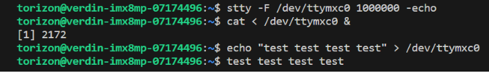

If the UART1 RX line is connected to the TX line the following works.
But if we try to connect an external device for the UART communication we can only send UART data and nothing is received.
If we substitute the toradex board with an Raspberry Pi and run the exact same program for the UART communication we can send UART data and receive.
Any ideas?

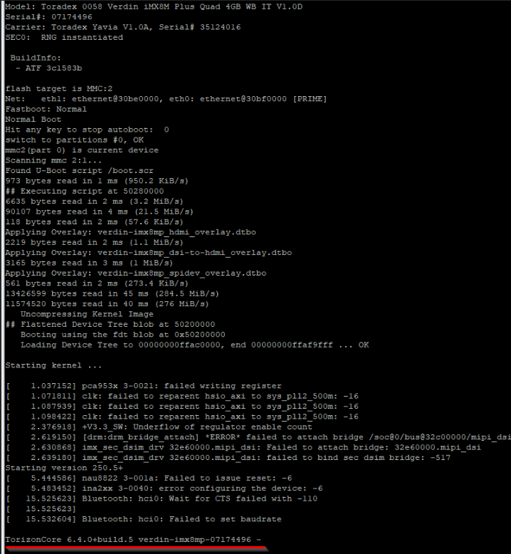

We are using the default TorizonCore 6.4.0

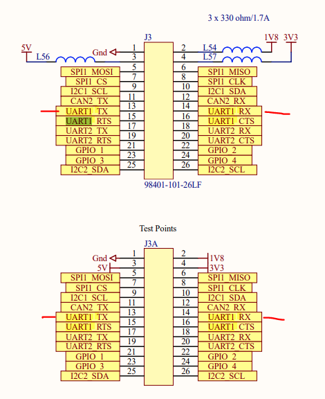

But there is an important point. I think you have already noticed it looking the Yavia schematics, but just in case…
UART1 lines are not connected to the USB A or C connectors of the Yavia, but they’re available on the expansion connectors
And they’re native 1V8 TTL lines.
If you want to connect UART1 to another device you should take care of the voltage levels.

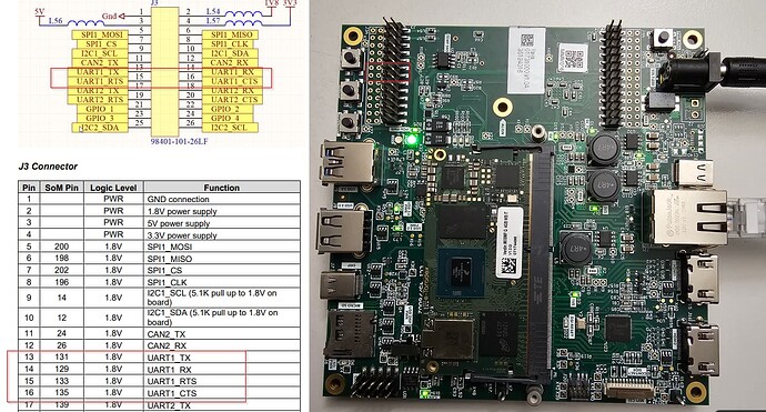

So my main question is why are there 4 Lines for the UART1 and do I have to use all 4 ? If we just use the default TorizonCore 6.4.0, is the default mode RS485 or can I just use the RX / TX lines like we do with an raspbery pi?
I use only TR/RX, so I don’t think that RTC and CTS are required.

Dear @dan
Could you let us know what device you are trying to communicate with?
The necessity of using CTS and RTS is dependent on the device you are using.

Would it be possible to let us know, what the device, to which you have connected the Yavia and Verdin, looks like? We need to know what the exact architecture of the second device is, in order to determine what signals are necessary for communication.
Best regards
Collin
Hi @dan
Please ensure that hardware flow control is disabled on both ends of the UART communication.
