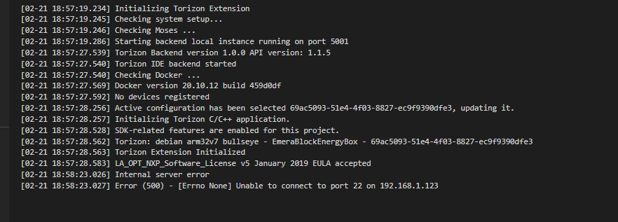

When I click Torizon Extension, Devices, + and enter my IP address, username and password, I get.
Internal server error :: Error (500) - [Errno None] Unable to connect to port 22 on 192.168.1.123

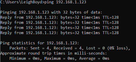

I am using the ip address which I find over the USB debug port by typing >
# ip addr | grep ethernet0
and I can ping it from my pc which gets replies.

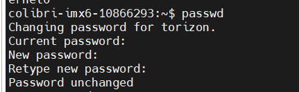

I know my password is correct because I did this:
here is my output

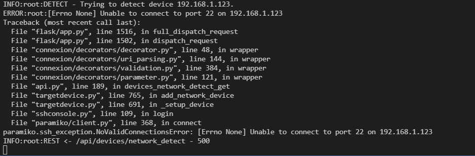

In the “Terminal Window” in the Torizon IDE backend process, I get these messages:
I expected it would try to create a 2nd device, but it still seems to be trying to open the old one.

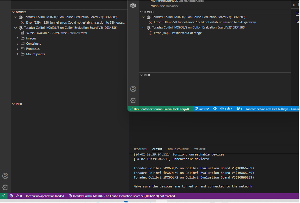

Seems like my fix worked only for a day.
I have recently need to switch between my two Colibri modules a lot. But when I swap them, I get these errors. One of them works, and one of them does not.
The error I get today is:
[02-23 15:44:43.718] No devices registered
[02-23 15:45:04.727] Internal server error
[02-23 15:45:04.728] Error (500) - [Errno None] Unable to connect to port 22 on 192.168.1.123
[02-23 15:48:15.189] Toradex Colibri iMX6DL/S on Colibri Evaluation Board V3(10866289) not reached
[02-23 15:48:15.248] Torizon: unreachable devices
[02-23 15:48:15.248] Unreachable devices:
Make sure the devices are turned on and connected to the network
I switch between my two Colibri modules a lot, and I need to know the best procedure to do this.

I can see that when I changed devices, and it asks me for the IP address, I give the info for the new board:
IP address 192.168.1.123
(it has serial number 10866293 although this is never asked for, just username and password are needed when adding a new device.)
However, when it is connecting I get these messages in the terminal window:
First you see it cannot connect to my .119 device (because I disconnected it)
Then it tries to connect to the .123 device, but it mentions the path /api/devices/10866289/image which is the first board…

  File "connexion\decorators\validation.py", line 384, in wrapper  File "connexion\decorators\parameter.py", line 121, in wrapper
  File "api.py", line 189, in devices_network_detect_get  File "targetdevice.py", line 765, in add_network_device
  File "targetdevice.py", line 691, in _setup_device
  File "sshconsole.py", line 109, in login
  File "paramiko\client.py", line 368, in connect
paramiko.ssh_exception.NoValidConnectionsError: [Errno None] Unable to connect to port 22 on 192.168.1.123
INFO:root:REST <- /api/devices/network_detect - 500

Still no luck with this. I can still only program with one module. This slows down our development considerably since others need me to program modules for them to get my lastest code, but I am forced to give them MY module instead (and I cannot code in the meantime)
Please help.

Still no luck.
Here’s what I tried this time:
use SSH from WSL to connect to my board:
ssh -v torizon@192.168.1.119

but now I swap boards to my 192.168.1.123 Colibri and try again.
ssh -v torizon@192.168.1.123
OpenSSH_7.6p1 Ubuntu-4ubuntu0.6, OpenSSL 1.0.2n  7 Dec 2017
debug1: Reading configuration data /etc/ssh/ssh_config
debug1: /etc/ssh/ssh_config line 19: Applying options for *
debug1: Connecting to 192.168.1.123 [192.168.1.123] port 22.
debug1: connect to address 192.168.1.123 port 22: Connection timed out
ssh: connect to host 192.168.1.123 port 22: Connection timed out
Then I re-installed EasyInstaller
Colibri-iMX6_ToradexEasyInstaller_5.6.0-devel-20220217+build.278
Then re-installed my image.
torizon-core-docker-evaluation-colibri-imx6-Tezi_5.6.0-devel-202202+build.21.container
and tried it again.
Same timeout response.
repeated the installation using a different (but exactly the same) image
tried again, same timeout.
it also doesn’t work to do an
ssh-keyscan -t ecdsa -T 240 192.168.1.123
simply times out after 240 seconds…
Do you think the module is damaged? I can still ping it, and log in through the usb port, etc.

got my third module on Friday.
Intially things were going well.
Here is what I tried:
  • downloaded windows-recovery.bat for Easy Installer v 5.3
  • downloaded Easy Installer v 5.6.0 build.9
  • installed Torizon Core with Evaluation Containers v 5.6.0 + myCUSTOMoverlay
  • connect serial port to get ip address, 192.168.1.158
  • changed password to torizon1
  • tried adding a device - didn’t work at first
  • remembered to add the device to the LOCAL VScode Torizon Extension
  • opened VSC as “new window”
  • hard-rebooted the target at random intervals
  • Finally the device was added! (10934586)
There’s where the good news stopped.

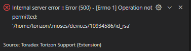

-Then went back to the remote window and clicked refresh, received error (500) - list index out of range

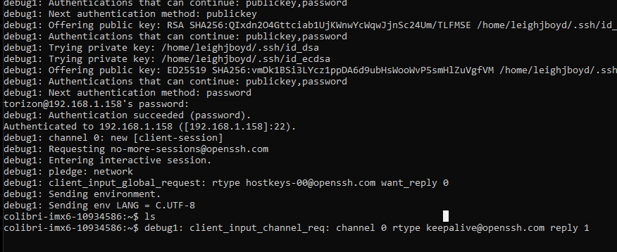

tried to SSH, this was sluggish but then allowed me to type a password and I could get in, but still could not connect to the device under Torizon Extension Devices.
-tried above procedure again, this time left-click on green >< symbol and choose “open folder in container” and selected my project… I get “trying connection …”
Finally it actually connected ONCE for a short time (5 min) and I though all was going to be good.
But then when I tried to open the SSH terminal, it kicked me off, as if someone clicked “refresh” on the device. I have never been able to get it to connect again, either getting an error message Error (500) - list index out of range or just “trying connection …”
Tried to rebuild the container (while in remote mode, perhaps I should be in local mode for this?) F1 - Remote-containers: rebuild container
Tried torizon-Extension: Detect device via network connection get an Internal server error: Error (500) Operation not permitted ‘/home/torizon/.moses/devices/10934586/id_rsa’
I have had a LOT of pressure to get a second module running as others on my team need it to develop, it didnt help that the replacement module was incorrectly shipped to our head office, and delayed us even further. Please help me to understand what I am doing wrong.
Unlike my previous behaviour earlier in this thread, however, I CAN connect via SSH from WSL on my pc. if I run ssh with -v option you can see the keepalive lines:
I feel I must be doing something wrong, which may even have damaged my last module, so I am stopping and would very much appreciate a detailed procedure (with expected responses/messages) to go from here, a fresh VSCode window. Should I then click the green >< symbol and open folder in container? You mentioned that you built a new C/C++ project, but should I do this when I already have a project? I would like to be able to switch effortlessly between the two modules.
It seems that the command to reboot the module (from Devices) has no effect, I wonder if a reboot is necessary at each connection attempt and this is why the connection is not happening?
