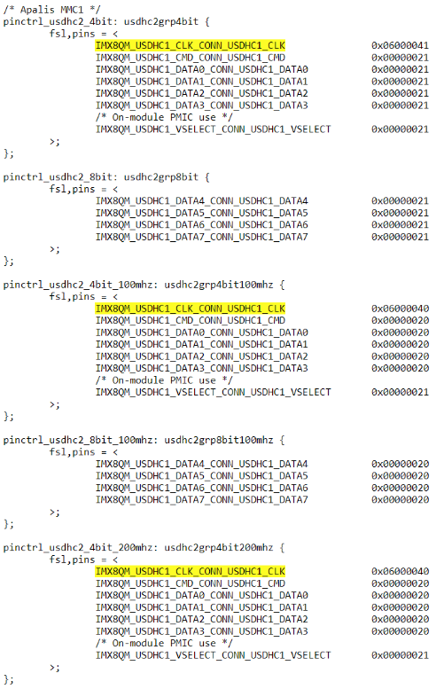

I am configuring the SD Card interface but I noticed that the pin 154 of Apalis imx8 is having an internal pull down while other sd signals are having internal pull up in imx8-apalis-v1.1.dtsi.
https://git.toradex.com/cgit/linux-toradex.git/tree/arch/arm64/boot/dts/freescale/imx8-apalis-v1.1.dtsi?h=toradex_5.4-2.3.x-imx#n725
For bit 5 and 6:
00b - prohibited
01b - pull-up
10b - pull-down
11b - pull disabled
Looking at 0x06000041 (0110000000000000000001000001), where bit 5 and 6 is10b right? May I know why this pin needs to set differently from other pin?
