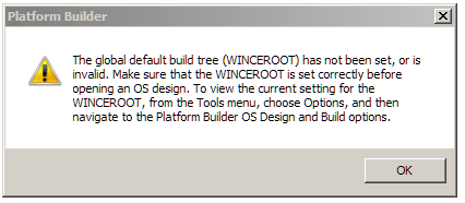

I followed the steps you suggested but I get error on WINCEROOT not been set:
How should I set this parameter?
Should I change it if I want to build different OS (CE6, WEC7)?
what combination of OS, Visual studio and Platform builder do you have installed?
Win 7 SP1 + VS2008 + WEC7 Platform builder
I will assume Windows T is Windows 7 :slight_smile:
Can you send me tree structure from C drive where all this WINCE files and folder are
I created C:\WINCE600 and C:\WINCE700 folders manually.
I extracted BPS and workspace from Toradex.
No other files or subfolders inside .
when you installed WEC7 it created WINCE700 folders right?
So put BSP (COLIBRIVYBRIDBIN) to c:\WINCE700\platfrom and OSDesign to c:\WINCE700\OSDesign
What else do you have inside WINCE700?
My instructions up there are for CE6 but you have WEC7
No, it didn’t.

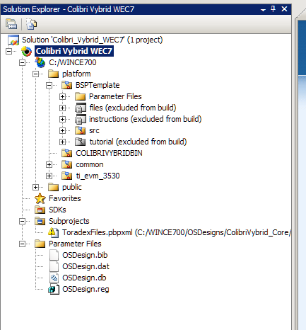

Hi @luka.tx
the project opens and I see the file tree in solution explorer.
I see that Subprojects >> ToradexFiles.pbpxml has a “warning” icon.
Double-clicking over it shows a popup message “The item ‘ToradexFiles.pbpxml’ does not exist.”
Is this an expected behavior?
One more thing: I successfully built the configurations “Colibri Vybrid WEC7 Checked” and “Colibri Vybrid WEC7 Release” without modifying anything.
I would have expected to produce exactly the same nk7.bin as it is included in Vybrid WinCE Image 1.5.
But this is not the case; the produced nk.bin is a little bit larger than the one included in the above .zip file.
Is this expected?
You can ignore ToradexFiles.
Maybe you have a bit different update level or a bit different compiler version. I think image you get is OK. I also test every release building this on a bit different version and never had issues.
