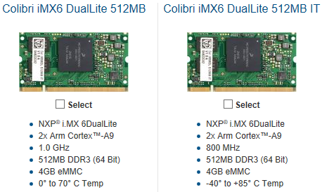

i want to flash the Colibri iMX6 to the WinCE version “imx6_winceimage_1.2-20170927.zip” in recovery mode.
  • Colibri iMX6DL 512MB 1.0A and 1.1A → works.
  • Colibri iMX6DL 512MB 1.1A IT → does not work.
The IT module stops at the “reading static config block” and waits forever.

Is it possible to flash the IT version in recovery mode, or is there a different way?

The reason we want to switch to the industrial grade imx6 cpu is because of the higher temperature range.
