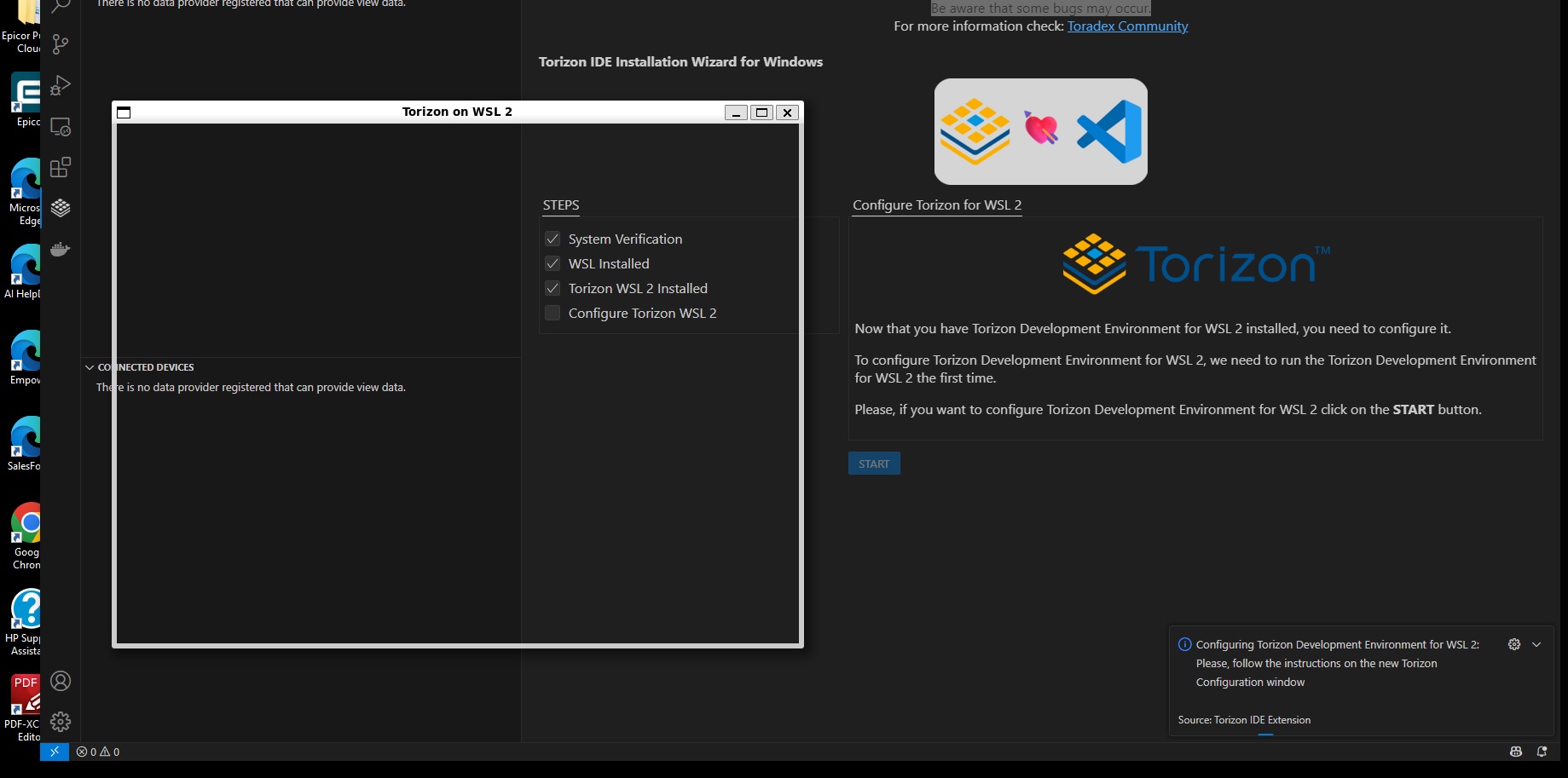

I’m a software engineer at Advanced Instruments trying to install Torizon in a container hosted on Windows 10. After installing the Torizon extension and during the configuration steps I get a blank Torizon window labelled “Torizon on WSL 2” (see screen shot).
I can’t find a way around this. Any help would be greatly appreciated.

Greetings @ramaral1090,
Could you clarify what you mean by “install Torizon in a container hosted on Windows 10”?
VSCode should be installed in Windows 10. Then, the Torizon extension should be installed after connecting to WSL as instructed here: Set up the Torizon IDE Extension Environment | Toradex Developer Center
Did you install the extension manually or by using the installation wizard?
