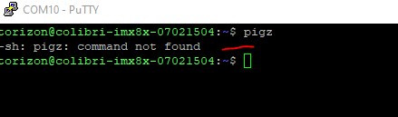

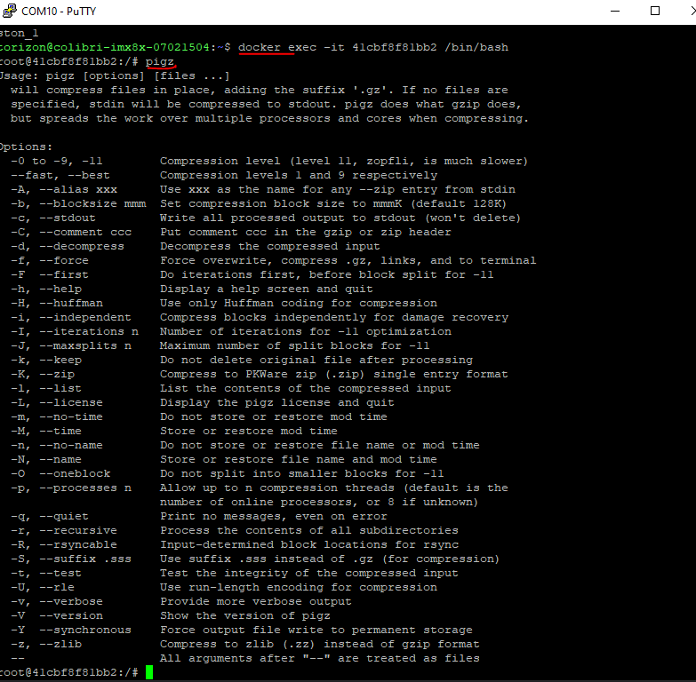

I like to install pigz package used for compressing and decompressing files. I’m able to install it by adding it to the Torizon: configuration bulidcommands. However, to use it I’ll need to enter the running container (2nd picture), how can I use it without going into the container like in the first picture? Thank you.

If you want to install a package to the base TorizonCore OS outside of a container, then you’ll need to re-build the OS image with Yocto as described here: Build Torizon OS from Source With Yocto Project/OpenEmbedded | Toradex Developer Center
You can then add whatever packages you want to the base OS. We can also consider adding it by default as a request, though these can take a while for our team to process and there’s no guarantee we will accept the request.
