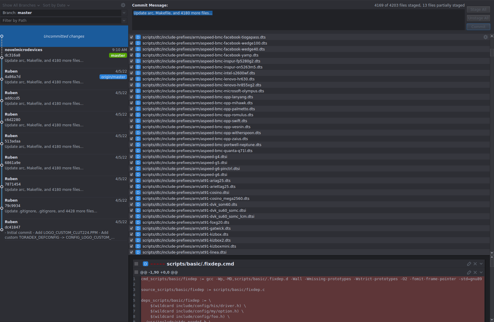

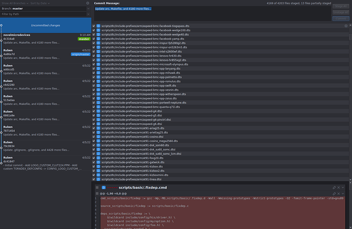

Hi @jeremias.tx ,
Sorry for the late reply, I had some trouble to pull my kernel to GIT, do Toradex does somethins especial with the syslink file? Because those weren’t going to my GIT and then I wasn’t able to build the image.
Thank you so much for you aid,
Ruben
What do you mean by “special”? Our kernel source does include symlinks but so does the standard linux kernel source. So I wouldn’t call what we’re doing “special”.
Hi @jeremias.tx ,
Sorry if it sounded rude but what I meant with “something special” was how did Toradex pushed the Kernel symlink files to the Git because I wasn’t able to do that. I had to remove the links manually and create static files in order to push my Kernel to the Git.
Regards,
Ruben
We don’t do anything special, Git should be able to just store and push symlinks as is. You can find many examples of this in other projects on Github. Have you tried researching your issue? Perhaps it’s not related to symlinks at all.
The problem was the symlinks, all the errors that I was getting in the Yocto build was fixed after I made the symlinks static. I look into some issue that people had with pushing symlink to Git but the only solution that worked for me was creating the static files instead of symlink file.
So our Linux Kernel repo has symlinks in it. The main Linux Kernel repo has symlinks in it. Both these git repos work just fine with symlinks. But you’re claiming that you can’t push symlinks to your Linux Kernel repo? You can see why I’m finding this strange.
Also you haven’t shared the exact error message you get when trying to push symlinks.
Hi @jeremias.tx ,
When I clone Toradex Linux Kernel or the main Linux Kernel I’m able to compile it and its modules. The problem starts when I try to push it, I can push all the files for the ones inside the symlink folder, as the image I’m attaching:
This was the error that Yocto gave me, as you can notice, the file that says is doesn’t exist is inside a symlink folder:
Regards,
Ruben
Well yes that error in Yocto is because your repo does not have the symlinks that were there originally and now the filepaths that depended on these symlinks got broken.
What I’m asking is what prevents you to just git push the repo with the symlinks as is. Just doing a simple git push on my side was all it took. Is the Git client you’re using in that picture preventing this?
Cause using git push from the command line has no issues handling the symlinks.
Hi @jeremias.tx ,
Sorry for the delay. I tried push it by command lines and I get the same issue, even if I commit and push. The git keeps warning me that is files to be pushed.
Regards,
Ruben
I’m not sure what you mean by this. Could you just copy and paste this warning that git is giving you, exactly as the message is given.
Why don’t you try debugging this step by step.
  • Step 1: Clone our linux-toradex repo
    • Are the present when you clone it?
  • Step 2: Push the linux-toradex repo to your new repo location. Make no changes do not commit anything, just push it as is to the new repo location.
    • After pushing does the repo still contain symlinks?
If this still doesn’t work then your Git is obviously configured differently somehow, and you’ll need to figure this out on your own. As I’ve said many times and have tested myself default Git can handle and push symlinks just fine.
