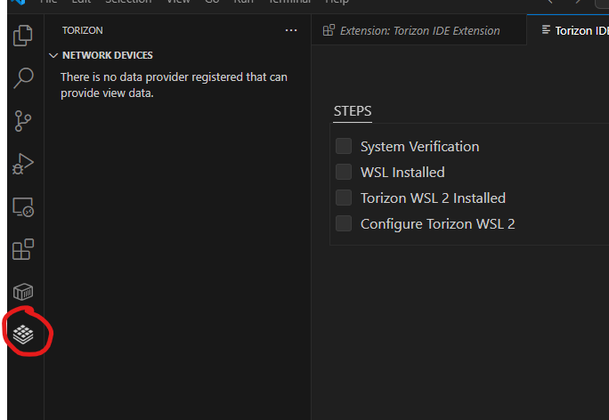

I am reaching out to report a strange issue I am facing during the installation of Torizon IDE Extension in VS code.
I installed the Torizon plug-ins by following the short video provided in Toradex community.
The main problem I observed when Click “VERIFY” command in Torizon IDE Installation Wizard.
The Windows PowerShell window briefly appears and then immediately closes. Following that, the “Torizon IDE Installation Wizard” becomes unresponsive — specifically, the “VERIFY” option remains inactive and cannot be selected.
Despite several attempts and verifying the installation requirements, the issue persists. I would appreciate it if you could assist me in resolving this matter or guide me through any additional troubleshooting steps.

Additional details I discovered in the Command Palette window:
An error occurs when I click on the Torizon extension.
mainThreadExtensionService.ts:107 Activating extension ‘Toradex.apollox-vscode’ failed: command ‘torizon.uninstallTorizonWSL’ already exists.
