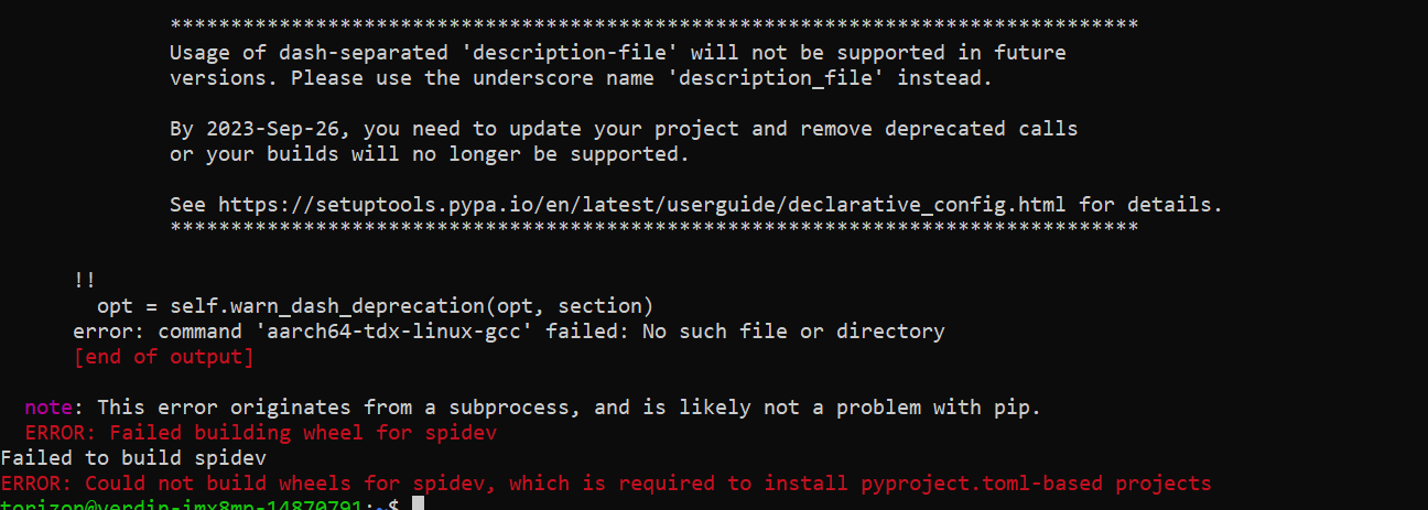

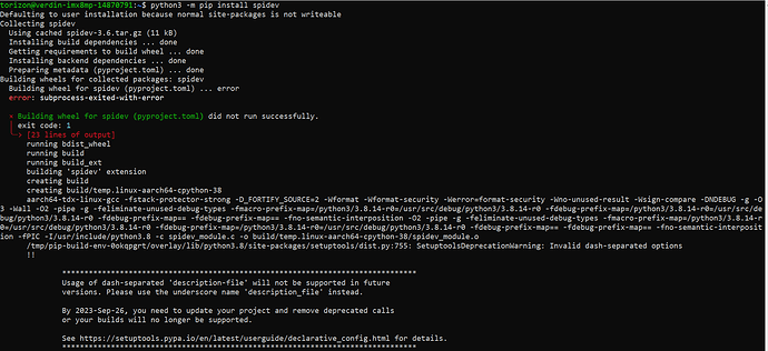

I’d like to install the “spidev” python library on Toradex Verdin IMX8M Plus. However, the following error message appears.
How do I install this library?
Thanks
Thanks
Hello @Nahel_V ,
You are trying to install spidev package directly on the OS which is not the way to go with TorizonCore, as it is based on containers.
You should run Python in a container, and from there install the necessary packages, as explained here:
(It is for TC 5 but should be applicable to TC 6 too)
Josep

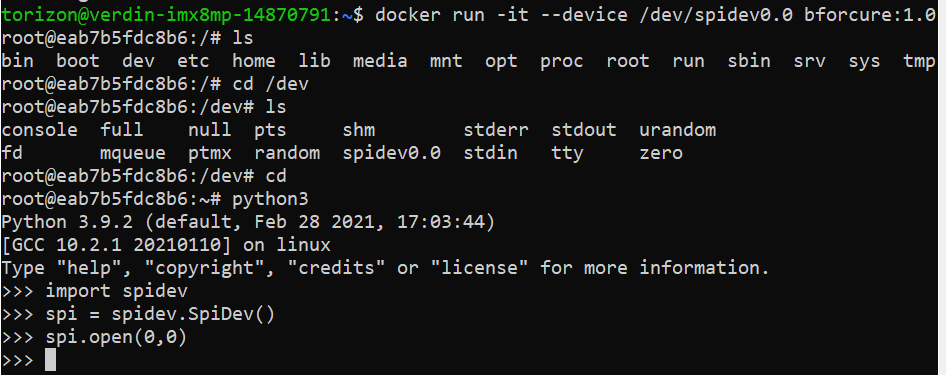

When I execute the command ls -l /dev/spi* I only see spidev0.0, and I would also like to have spidev1.0, spidev1.1, spidev2.1

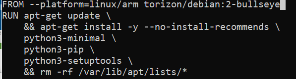

Here is my Dockerfile for using the spidev library :
I use the commands :

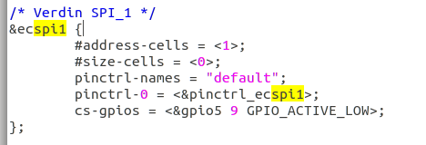

Actually, this doesn’t happen by default. If you want to use the other (non-standard) SPI interfaces of Verdin iMX8M Plus, you need to enable them. Please refer to the following article and datasheet to learn more about the standard interfaces of Verdin Family.
Verdin Family specification might be useful here as well:
To enable the other SPI interfaces, you will need to customize your device tree (or create and apply a device tree overlay). We have some nice articles about device trees and customization. E.g.:
