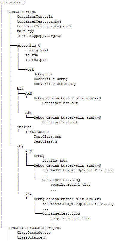

When executing tree in /home/build/ on the corss compilation container i get following structure:
[upload|MRGGQY0DMk9qZVd1dsqkLBk2pX4=]
But as soon as I inlcude files that are outside of the project folder (ClassOutside.h and .cpp) Visual Studio 2019 will create a cascaded folder structure and the torizon extension will fail at the rsync command. I noticed that the folder structure has been changed:
[upload|PVibaA8JBbSH0r1mkxy4JYAuHrY=]

The changed directory structure after you include the outside files is strange. Mostly the “ContainerTest” folder inside the first “ContainerTest” folder.
Correct me if I’m wrong but if I understand correctly you added the “TestClassesOutsideProject” folder using the Visual Studio option of: Project > Add Existing Item
From what I can tell in the 2nd folder layout picture, “TestClassesOutsideProject” should be in the same folder as main.cpp normally if the files were added to the project properly.

yes, i added the files within the “TestClassesOutsideProject” folder using the Visual Studio option of: Project > Add Existing Item.
following screenshot shows the path to the external files (located in TestClassesOutsideProject)
I followed the scheme as presented in the “Setting up the InfluxDB API” section, but in my case i was copying the files TestClass.h and .cpp into /include/TestClasses and then added them accordingly with “Add Existing Item”. This worked fine.
But as soon as i went a step further and tried to “Add Existing Item” without first copying the files to the folder structure (as with the ClassOutside.h and .cpp) i got this issue.

I ran this issue by our extensions team and it turns out that this is an actual issue with how VS tries to sync the folder when adding outside items, this in turns messes with our extension. Which explains the odd folder structure you’re getting after adding outside items.
What this means is that you’ll run into a similar error anytime you try to add files/folders that our outside of the project folder. For the time being before we can create an official fix you’ll need to work around this on your side. You could either copy the files/code into the project folder itself, as you’ve done with TestClass.h and cpp this could probably be done as a pre-build local step of some kind. Another suggestion would be perhaps you could try something fancy with linking the outside files into the project folder.
Sorry for the inconvenience, but your feedback is very appreciated. As well as your directory structure example since since we are not 100% sure ourselves how VS generates this messed up folder structure.
