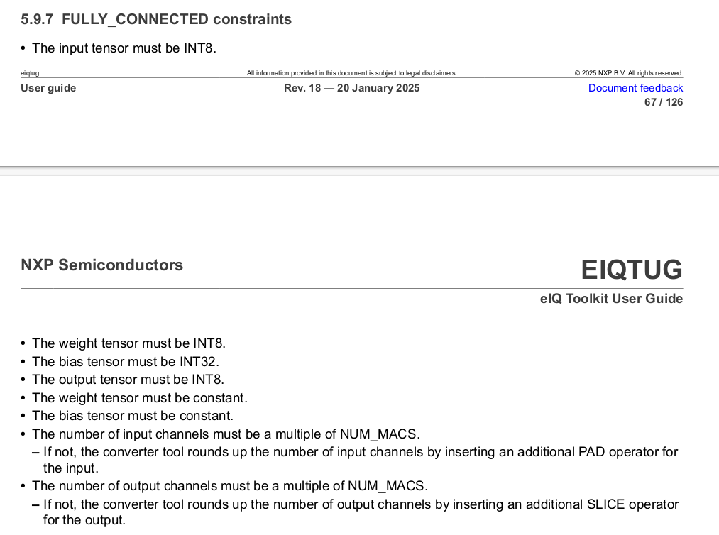

The iMX95 Verdin EVK has been flashed with latest available Linux image L6.12.3-1.0.0_MX95. We have plans of switching the AI-based defect detection solution to the i.MX95 platform, As a initial step we tired converting a few models for benchmarking. Thus installed eIQ_Toolkit_v1.14.1 in ubuntu host and converted the tflite to neutron supported tflite using the converter. But for classifier such as such as InceptionV3, Resnet50 and Mobilenetv3Small, On converting fully connected layer to ConvertFullyConnectedToConv, it is showing internal error.
The fully connected layer which is not getting converted does not violate any of the constraints mentioned in the section 5.9.7 FULLY_CONNECTED constraints of UG.
How can we fix this issue as I am unable to run any classifier with fully connected layer in iMX95 Neutron NPU.

You’re correct that, according to the documentation, fully connected layers should be supported as long as they meet certain constraints. Since you have checked that your models comply with section 5.9.7 (FULLY_CONNECTED constraints), it appears you have already covered the common issues.

May I know how to get the support team included. Able to convert a single fully connected layer but need to know why this issue occurs in classifiers which are listed in the supported model in the documentation. Couldn’t get more logs only its shows “internal error” while converting fully connected layer no issue with rest of the layers. I shall share one of the model which was showing error for the respective layer. I am unable to add attachment. Please let me know how to connect with you.
