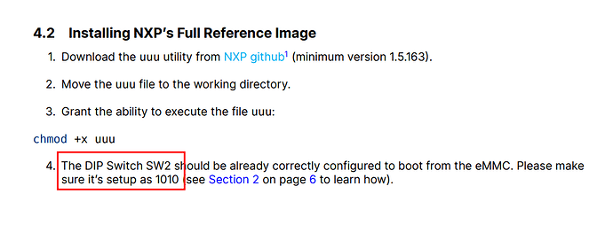

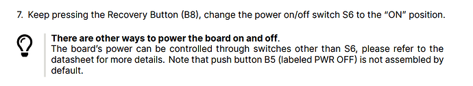

Hi , Thanks for your response Allan. I had gone through the Getting Started PDF and under the recovery mode section the switch SW2 is set at 1010 for eMMC booting. Should we continue with the same configuration in SW2 for flashing through Easy Installer ?
Hi , I had gone through the Getting Started PDF and under the recovery mode section the switch SW2 is set at 1010 for eMMC booting. I have currently connected my USB and turning on to recovery mode, when I give sudo uuu -lsusb I am unable to see any devices of NXP. Can you please confirm the switch configuration. Thanks
Hi @Harish-23
Please check the provided document.

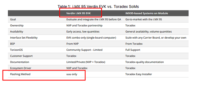

Check table 1 in the section 1 page 5.
The Toradex Easy Installer is not compatible with this EVK.
Check section 4.2 step 4. The correct DIP Switch position is 1010.

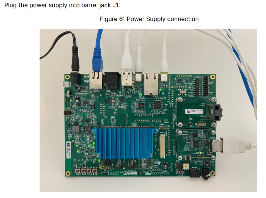

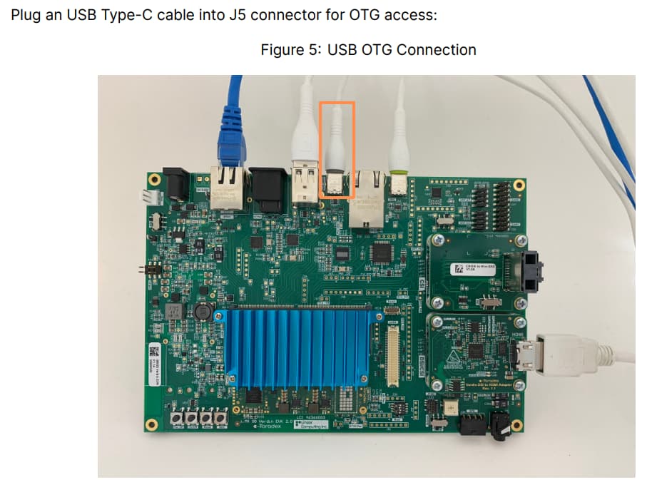

Can you confirm that you have the USB-C in the correct connector?
Do you see the LEDs during power-on?
You should be able to see the device under uuu -lsusb after powering the device with B8 pressed down.

Since we won’t be using the Easy Installer for flashing, I wanted to check if Toradex provides any prebuilt images that can be flashed directly using uuu. I currently have the BSP 7 Nightly Release, but I couldn’t find any .wic file similar to ./imx-image-full-imx95-19x19-verdin.wic.
My goal is to flash the base BSP image directly. Could you please guide me on the next steps or let me know if such prebuilt images are available for use with uuu?
Hi @Harish-23

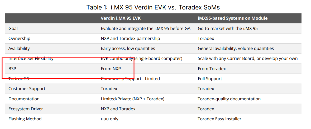

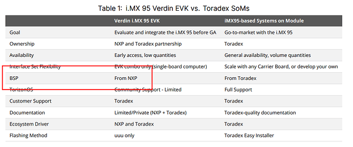

There is no BSP 7 for the NXP iMX95 EVK.
