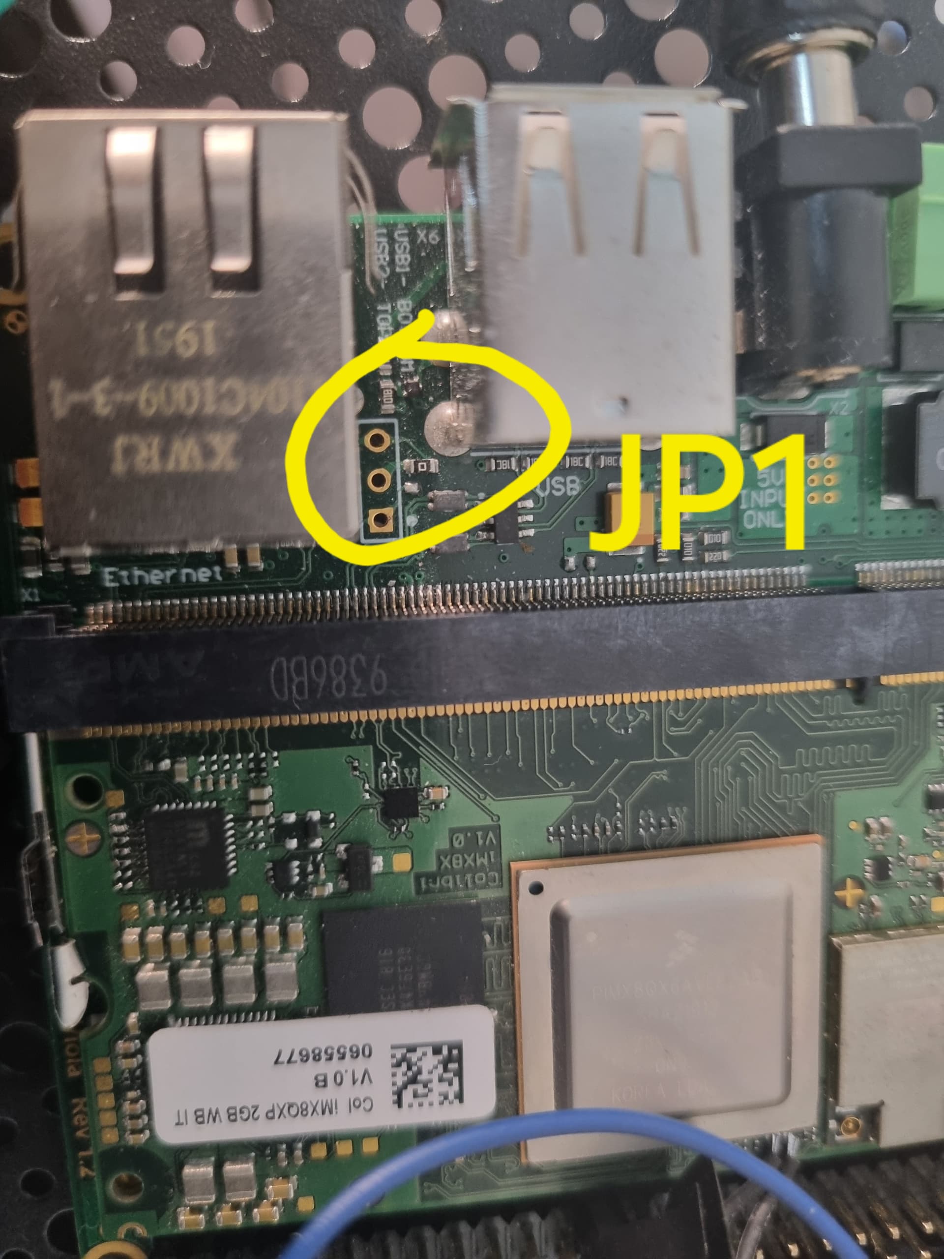

I still have a problem putting the card in recovery mode.
It seems like you forgot to tell me something about JP1. Correct?
If so, how should I treat JP1 on my Viola Plus (along with that jumper, already mentioned above) to put my Kit in recovery mode?

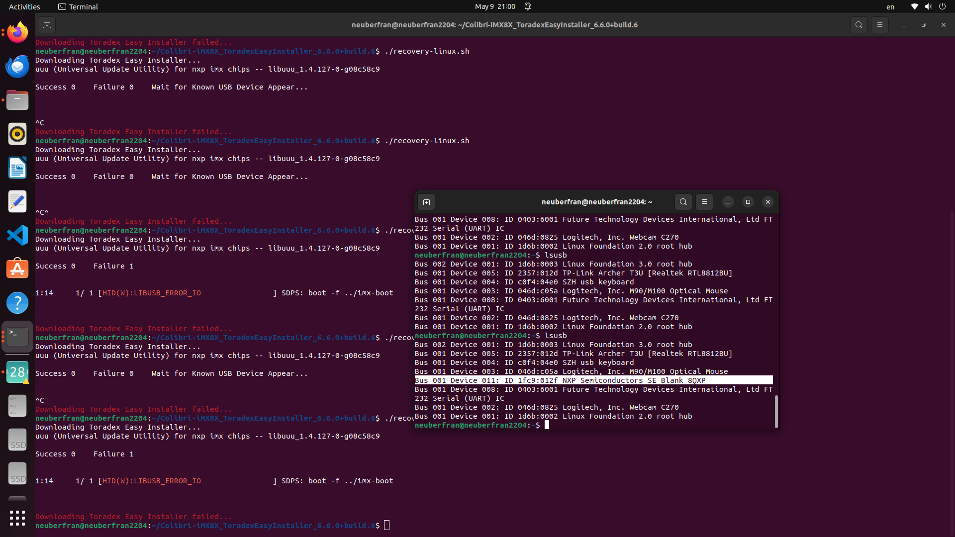

1:14 1/ 1 [HID(W):LIBUSB_ERROR_IO ] SDPS: boot -f ../imx-boot
Downloading Toradex Easy Installer failed…
