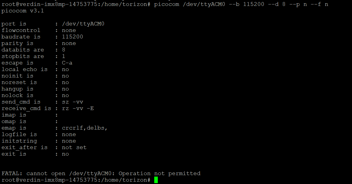

  1. Concerned USB Port for STM32 has been detected as ttyACM port in imx, but we couldn’t open the port for further communication
  2. We tried with picocom and minicom serial tool to manually open the port, but still we got “operation not permitted” response for the concerned USB port
Sounds like a permission, issue perhaps. Have you tried accessing the port with higher privileges or as root? Also how exactly are you running picocom/minicom in this case? I don’t believe any of our default OS images have picocom or minicom installed by default.

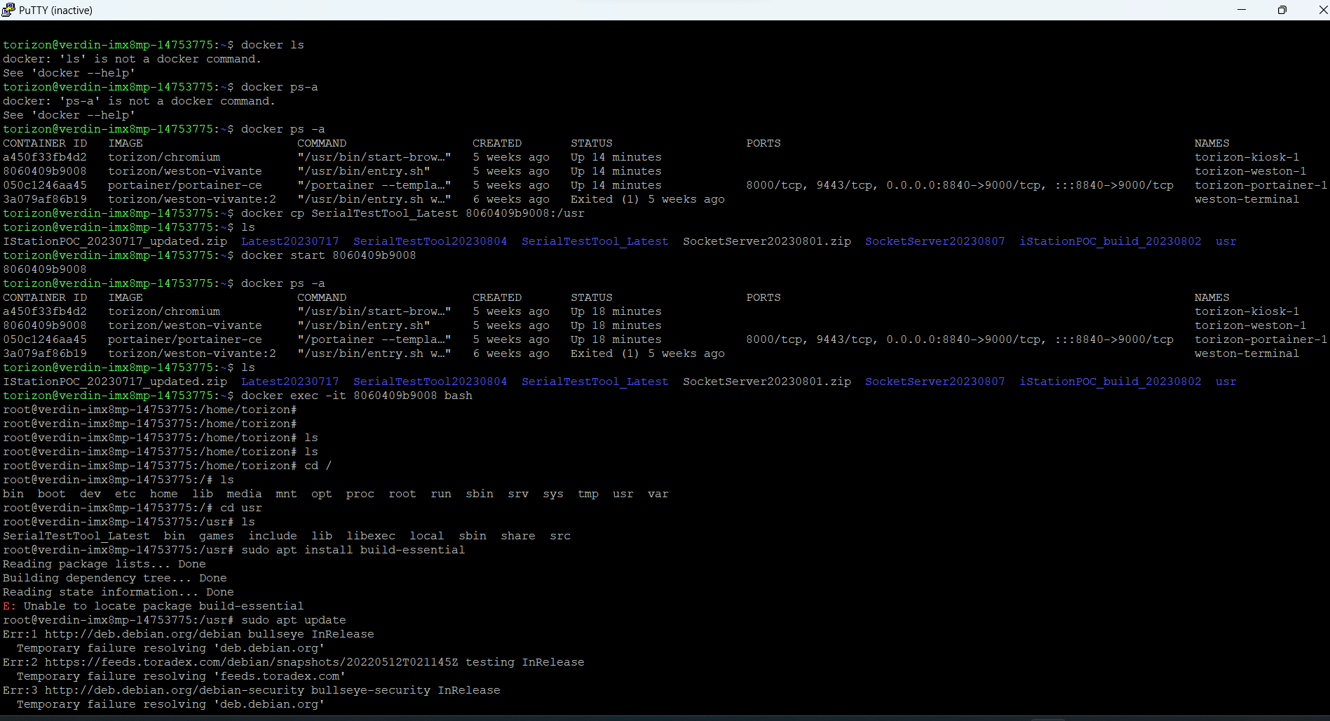

We are connecting SOM through SSH in putty Software
We have installed picocom by giving " sudo apt install picocom" command
We are accessing the port with root privileges
Kindly suggest any solution ojn how to access the USB port and intiate communication
Please Find the images (terminal window)
Okay I see you have a container that you installed picocom in. How exactly are you starting this container? Does this container have the right permissions to access /dev/ttyACM0?
