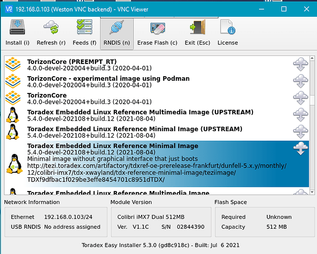

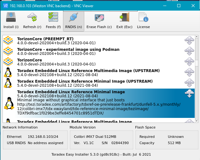

After installing image and for faster boot time adding “quiet” to U-Boot defargs variable. The problem is I see new unexpected dmesg error compared to quarterly 5.3.0:
[ 0.085457] reg-fixed-voltage regulator-module-3v3-eth: Failed to register regulator: -517
