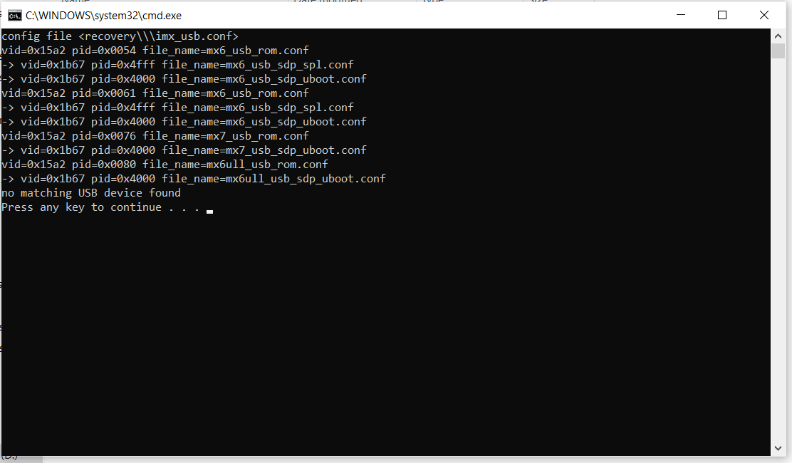

In recovery mode, i tried running windows-recovery.bat file to reload easy installer. But error message appeared on screen " no device found"

Hi… Did it again following the page you have shared. But no luck.
