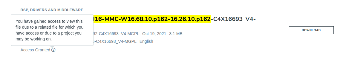

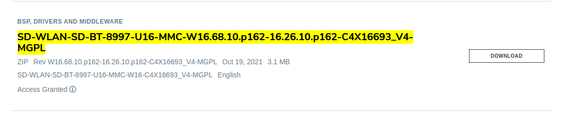

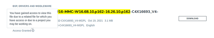

I still cannot download the file.
I signed a NDA and it was granted. After that I asked for access for secure files in wireless area and it was accepted. When I search for 88w8997 nothing return.
In your printscreen there is an “Access Granted” shown, I think access to some kind of Secure Files is needed before I can download it. Maybe this part is ascent in your tutorial. The possible areas to ask to access are: Processors and Microcontrollers, Interfaces, Power Management, RF, RFID, Security and Authentication, Sensors, and Wireless Connectivity. When you click in the “Access Granted (i)” shown in your print screen, some information pops up?
Hello.
I couldn’t download even with the direct link. I tried in Firefox and Chromium. I friend could not download it either. The only explanation that I could think was because we use IP from Brazil. I will try to ask to access Processors and Microcontrollers Secure files and if even this not work, open a support ticket in NxP system.

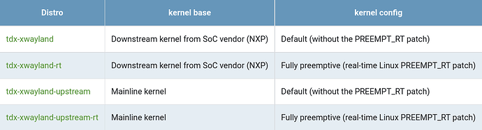

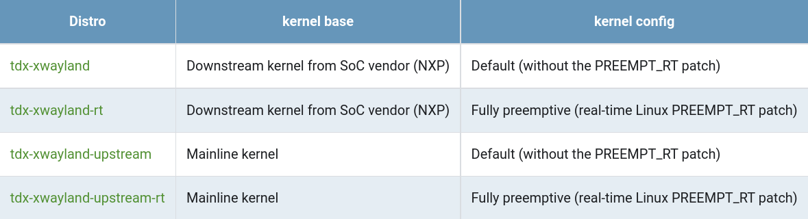

Moreover I check the recipe inside the meta-toradex-wifi and I see that it extends linux-toradex_%.bbappend , but using BSP 5.7.0 the default kernel is linux-toradex-mainline (even in my case, I didn’t change any variable to control upstream vs downstream).
I see that the default branch for meta-toradex-wifi is 5.3.0, but I am not sure if it refers to the Toradex BSP… Can someone clarify this?
In the past I was using BSP 2.8b6 with backported driver and everything works well…
Are you seeing the same error? Unfortunately, this comes from NXP with an NDA, it’s not something we are allowed to share here. Can you send a message to NXP asking for these drivers?
With the Yocto layers, the default kernel is downstream, if you check the local.conf file, you should see the distro configuration:
# Use this distro by default
DISTRO ?= "tdx-xwayland"
You are correct, this refers to the BSP 5.3.0. Checkign the code, I believe there shouldn’t be a problem to use this branch with 5.7.0. Thanks for pointing this out, we will update the repo as soon as possible.
