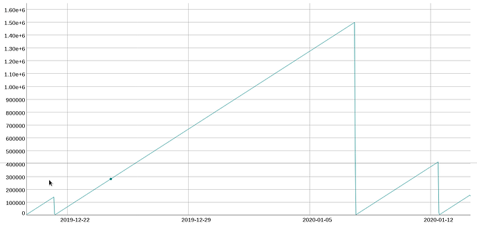

I have now a dummy script in place, rebooting the system if Firmware wakeup failed
pops up in the logs.
As you can see in the following image (showing system uptime), the problem occurs irregularly.
Thanks for the Input. Bsp 3.0 is beta/development version. For the production, you should stick to Bsp 2.8b6.
Jaski
